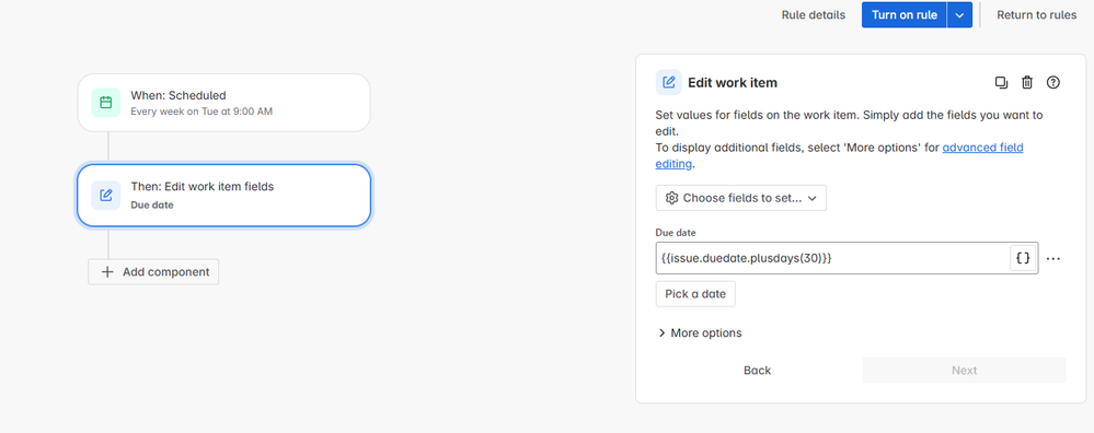

Currently working with Free Jira and wish to push back and entire project plan by 30 days for various reasons.
I can't seem to do this with bulk change as the date is fixed and I want variable, which the field in Edit Issues won't accept.
I believe it is possible in Global automation and have set the rule to apply to the specific project but cannot get it to run across all issues, only one at a time with a manual trigger. This is OK but I believe it possible to change the entire project with scheduled automation. This however keeps telling me I need a branch but not what the branch requires so I am a bit stuck.
My statement in the rule is {{issue.duedate.plusdays(30)}}
Any help would be appreciated as it is a huge timesaver for me

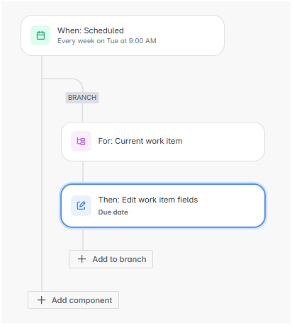

I think i found a working solution for you:
  1.  Create a trigger "When: Scheduled"  set End date to "One occurence" and add a JQL i.e.  "project = XXX and duedate is not empty" so you filter out the issues you want to update.
  2. Add a FOR EACH branch and select "Current work item"
  3. Add a THEN step and choose to update the field "Due date" and paste your smart value {{issue.duedate.plusdays(30)}}
  4. Set the date and time for when the trigger should fire and update the rule
I would recommend to test the rule for a small number of issues first and validate the functionality (narrow down the JQL to only include a few issues).
The rule would look something like this:
Let me know if it helps!

Ian Rickwood
June 24, 2025
Hi Staffan,
It works when I put {{project.Test}} as the statement in the trigger for the rule but the branching you gave me helped a lot, thank you.
I am able to shift my projects out as desired, thanks again to the community.
Ian R

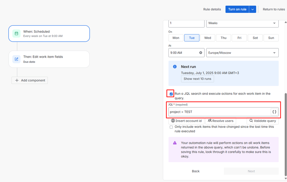

You can create a scheduled automation rule that selects issues using a specific JQL query and performs an action for each of them.
The key part is crafting the right JQL — it should accurately target only the issues you want to include in the automation.
Ian Rickwood
June 24, 2025
Thanks Evgenii,
That was the last piece of my puzzle, thank you, I will try that out.
Ian R
