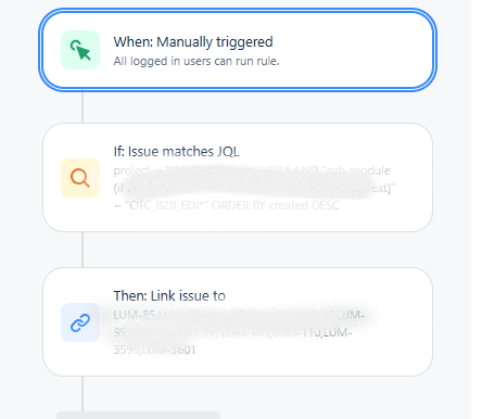

Amna Khan
September 20, 2024
thanks for the idea, i created an automation rule and it worked like a charm. thank you

Amna Khan
January 15, 2025
sorry for the delayed response, here is the rule that worked for me. in the 3rd step i added all the Jira Key numbers that needed to be linked to all the other Jira tickets resulted from the filter in 2nd step. Hthrule.png

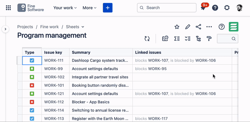

Hi @Adam Taylor
I'm curious about more targeted solutions, but you should be able to do this relatively easily using the app that my team and I are working on, JXL for Jira.
JXL is a full-fledged spreadsheet/table view for your issues that allows viewing, inline-editing, sorting, and filtering by all your issue fields, much like you’d do in e.g. Excel or Google Sheets. It also allows bulk-editing any editable issue fields - including an issue's issue links - via copy/paste. This works across JXL and pretty much any other app, like for example Excel.
So what you could do is,
  • Create a JXL sheet with the issues that you want to update, and add the "Issue links" column
  • Copy/paste the column to Excel or Google Sheets, and update all issue links, e.g. via find-and-replace.
  • Copy/paste the updated issue link values back into JXL.
This is how this could look in action:
(Just an obvious disclaimer to be cautious to make the right changes to the right issues, since reverting unwanted changes in Jira can be quite a pain.)

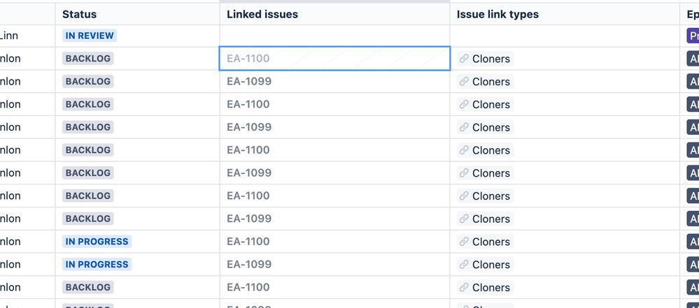

Hi @Keith Mangold
mind trying the Issue Links column (as opposed to the Linked Issues column)?
The Issue Links column will list the individual issue links (like, e.g., clones EA-1100) and is editable, while the linked issues column is just listing the linked issues (e.g., EA-1100) and isn't currently editable.
If there are any further questions, please feel free to reach out to https://jxl.app/support anytime and we'll have a look into it!
Best,
Hannes
Keith Mangold
October 20, 2023
That was it @Hannes Obweger - JXL for Jira ! Thank you!
Atlassian Partner
October 20, 2023
I'm just realising that we actually renamed this column from Linked Issues to Issue Links a while ago - so no wonder you ended up with the wrong column. Updating my original answer now!
