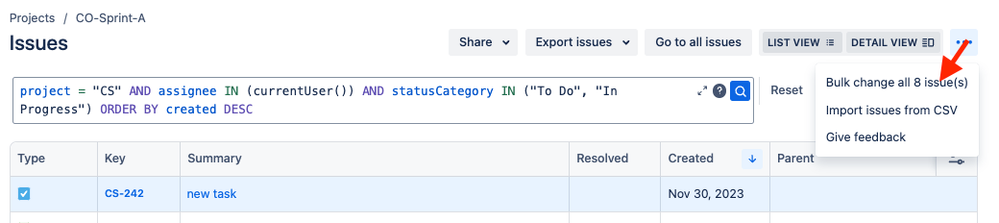

Looking at a Company Managed Software project, from the left panel select Issues, then My Open Issues correctly lists all the issues assigned to me.
From that list click the ... button in the upper right corner and select Bulk Change.
This change the current browser tab, which was display the above list, to the Bulk Edit operation screen.
Select the issue(s) to change. In my example I'll select just the one visible in the above image.

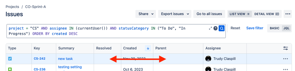

On the progress page, when the change is completed click the Done button. This changes the current browser tab back to the issue list.
But the list does not reflect the bulk changes made.
The same happens from the View all issues screen if you are using the new Search experience. However in that case the Bulk Operation screen opens in a new tab, and that tab closes when you click the Done button at the end of the bulk operation, so you are left with the original tab with the original results.
