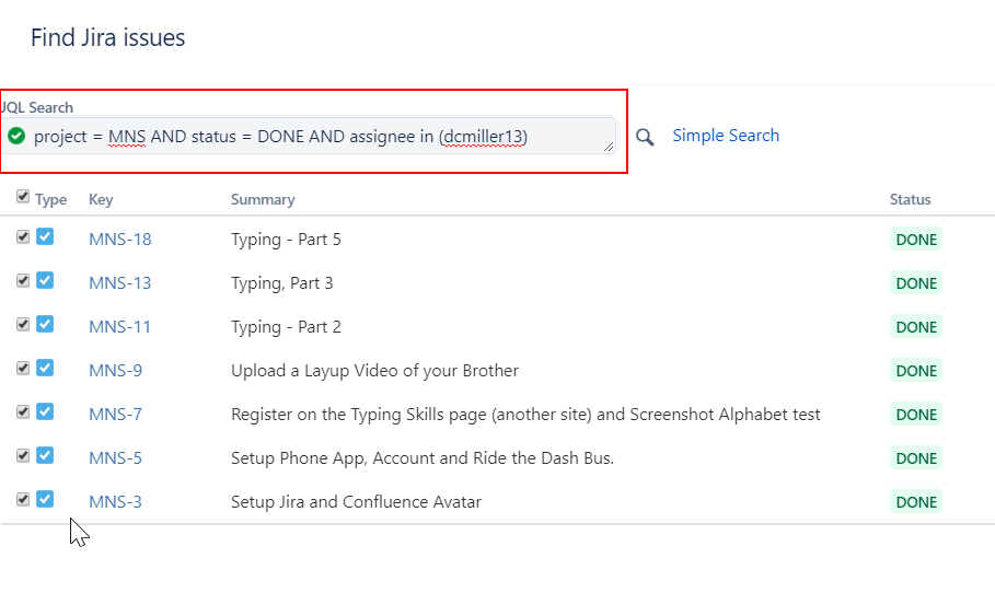

Bill Miller
August 6, 2018
Here's my solution...
Using Jira Cloud...
  1. Find the Issues you want to bulk link to another issue
  2. Click Advanced query.  Copy the JQL statement.  (e.g.: project = MNS AND status = DONE AND assignee in (dcmiller13)  )
  3. Find the issue you want to link to.  Click Link, pick the Link type, then  --> Search for an Issue --> Advanced.
  4. Paste the JQL.  Click the top checkbox to select all.

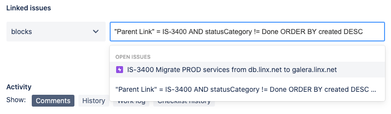

Matthew Day
November 4, 2020
I just tried this using a parentlink in the advanced search, and it returned all the tasks in that epic, but when I tried to link, it just linked the epic, not the tasks. :-/

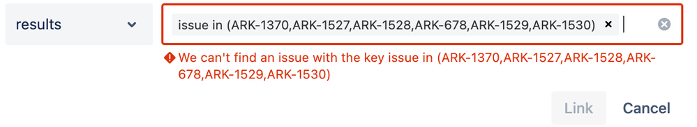

Florian Royer
March 21, 2021
This solution doesn't work for me...

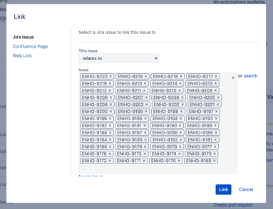

Nicholas Vidal
October 7, 2020
It's October 2020 and we still can't bulk link... but Jonathan's workaround was a huge help!
Not sure what to do though once Atlassian discontinues the old issue view though...

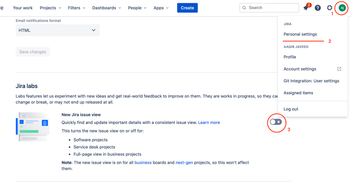

Aaqib Javeed
November 3, 2020
Steps for bulk update:
1. Switch to OLD view of Jira by turning off the "Jira Labs" toggle
2. Filter out all the tickets you want to link and export it as CSV file
3. Copy all the issue IDs from the CSV file in one go
4. Open parent ticket -> Link Issue -> ctrl-v / cmd-v all the copied issues in the field
5. Just click outside the text field (un-focus)
6. Click "Link" and there you go!
Just hoping this feature to be added in the new view as the old view will no longer be supported in coming days.
