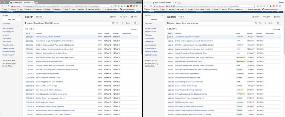

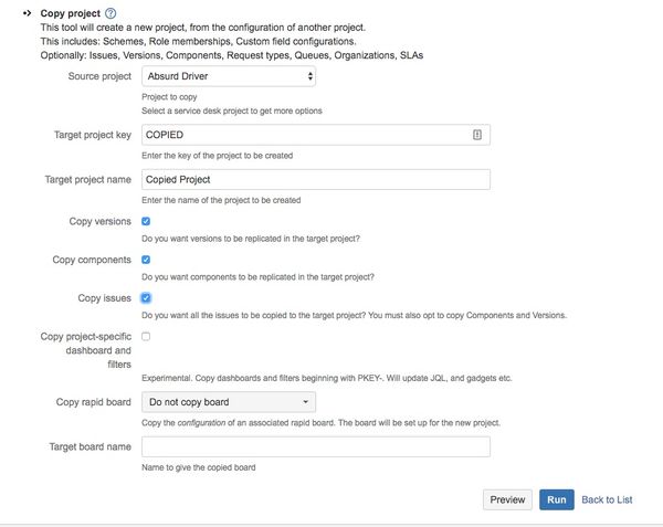

Hi Felix,
I tried a project with just 67 issues. This was the configuration:
And the result:
Don't worry about the data, it's test data generated by Jumble.
