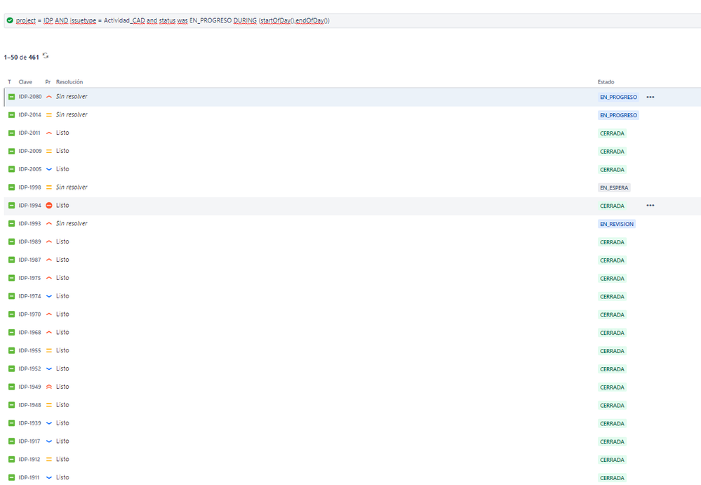

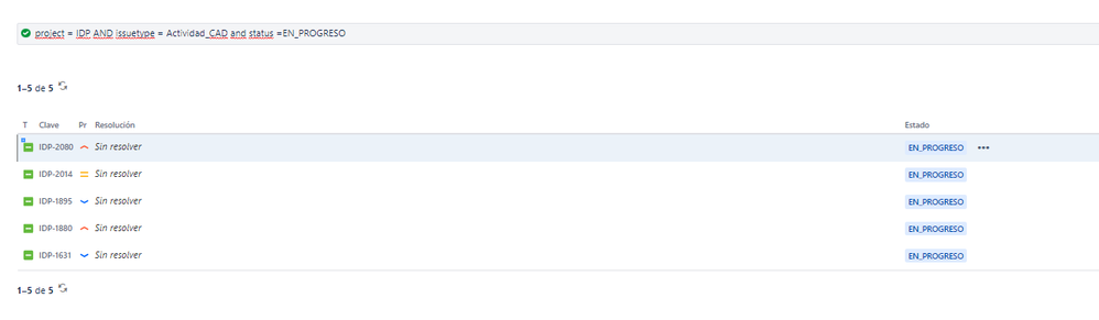

I have seen this issue:
https://jira.atlassian.com/browse/JRACLOUD-79741
Here it is an image of the search:
first performing the search shows near all of the issues in the project. And the search was for the in progress issues today. More or less same search doing status=in progres (today) shows that today only 5 where aprox in in progress.

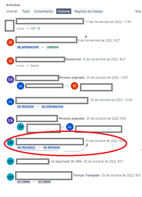

Looking at one of the previous list is shows the issue transition out of in progres in october 2022. Doing the same search in Jira server shows correct results. Let's see if it is already solved. I have tried using status id but no luck.

Can you show use the results of the search in List View, showing the Status field? You can obscure any confidential data. If it contains issues you think should not be there, can you show us the status change entries from that issue's History?
