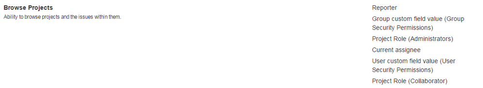

May 19, 2017
You've given this person the right to view the project.  So he can see the project.  I don't see any problem here.
fiorellasantopietro
May 19, 2017
Hi Nic,
thanks for your answer. Unfortunately, even if inside the Browse Projects there isn't the group of the A user, he can see the project on the list of "all project types - all categories".
 I'd like to hide the project even inside this list. Is there any chance to do this?
Nic Brough -Adaptavist-
May 19, 2017
Browse projects will only list the projects the user can see.
If you want to hide a project, you need to remove the user's browse access to it.  Check the permission scheme for the project and look at who has "browse".  You need to make the user *not* match any of the rules in there.
fiorellasantopietro
May 19, 2017
Hi Nic,
I did it. I set in this way the "browse project permissions", and my user A is not in any of this case.
I tried to re-index all the project but notthing happened.
Do you have any idea?
Thanks in advance,
May 20, 2017
Your user *must* be matching one of the rules that allows browse rights.
I'd re-check all the role memberships of course, but I suspect that they either have "create issue" rights, which would allow them to become a reporter, or they are selectable from the custom field you have in the scheme which would also give them the right to see an issue in that project.

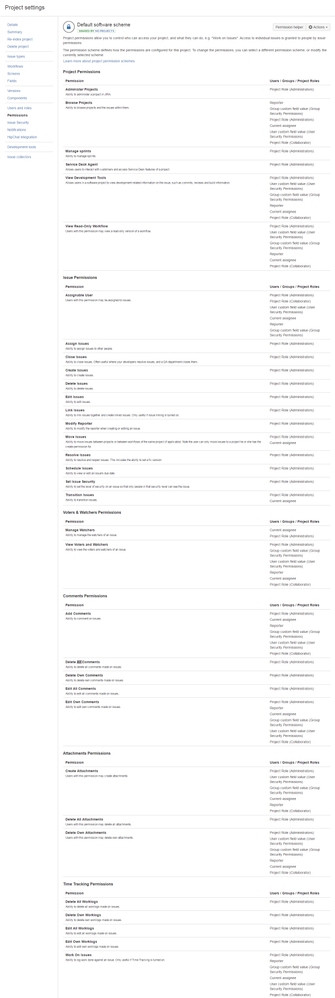

lpetri-orion
October 3, 2019
I too have the same issue. There should be an easy way to show only the projects a given user is related to in the project browse screen "secure/BrowseProjects.jspa".
There are many cases which users shouldn't know a given project exist.
