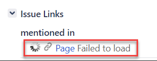

Some Jira tickets link to a Confluence page where they are mentioned. Since the migration these links do not work anymore, since the URL (domain) has changed.
It looks like this on the ticket: (link is invalid)
First of all, is there a way to find all these broken links on the tickets somehow?
And secondly, do you think there is any to repair these links in an automated way?

Whichever solution you implement, to update the broken links in Jira will require directly updating your database.
You will also have to determine the new Cloud URLs for each referenced Confluence page since the URLs are changed during the migration. The URL changes are not just to the base URL, but also to Page IDs, so it is not enough to just change the base URL.
Did you open a ticket with Atlassian support to support you during this migration effort? If so, you can work with Atlassian support through that ticket to get information about the SQL queries that need to be executed to collect the data and then update the database.

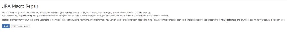

One additional question, in the Cloud I have found the "Jira Macro Repair" menu (see attachment).
Would that be something that could help for this case?
What does this process actually do and can I just let it run in production without any risks?

Regarding the Jira Macro Repair tool in Confluence Cloud -
Each Jira Macro you inserted in Confluence on-premise has a reference to the Jira Application link for your on-premise Jira instance. When you migrated Confluence to Cloud, if you had to create a new Application Link to Jira using an Application Tunnel, then those macros are no longer referencing a valid Application Link. The Jira Macro Repair tool looks for Jira Macros that reference an invalid Application Link, and allow you to map those macros to a new, valid Application Link (that you already created in Confluence Cloud).
That tool does not repair explicit URL references outside of Jira Macros.
