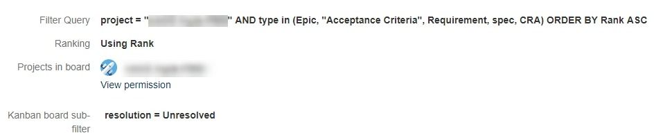

Can you do a screen shot of an issue that disappears? Or can you post your base query here?
Ankit Patel

Bill Sheboy
June 11, 2019
Hi @Ankit Patel
With... resolution = Unresolved as a sub-filter, Unresolved is a specific value, not the case when resolution is not yet set.
Consider instead using:
(resolution IS EMPTY OR resolution = Unresolved)
