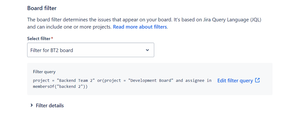

@Trudy Claspill I created different boards because the teams wanted.

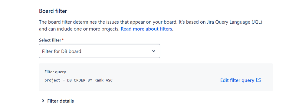

This is the Filter for main DEVELOPMENT BOARD.

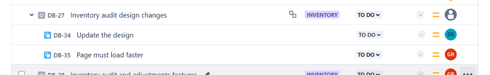

In this picture you can see subtask assigned to guys from front end and backend.

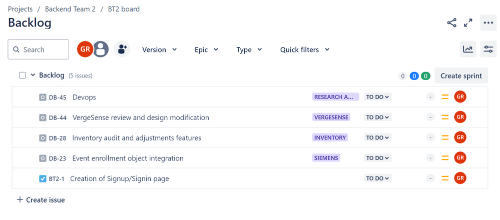

This is the filter details for Backend team 2.
I don't see the subtasks here as assigned on main Development board. Please help me with this.
The subtasks cannot display when their parent tasks are not included in the board. Since the parent task is not assigned to the member of the team, it is not being included in the team board. Assign the parent task to a member of the team.
Note that subtasks cannot be assigned to a sprint separately from their parent task. They inherit their Sprint setting from their parent task. If you have subtasks under a single parent split between two teams running independent sprints, they will not be able to assign just their own subtasks to their own sprints. In that case you need to have separate parent tasks for each team so that all the subtasks belong to just one team.

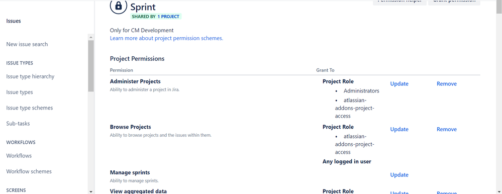

Also, please tell me how to disable managing sprints on development board.
Some screenshots would be very helpful.
Please be clear about the terminology.

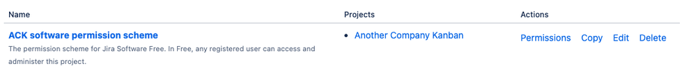

Managing Sprints is not a permission that is set per Scrum board. It is set for the Jira Projects that the board references.
For the Development Board Project you would need to look at the Permission Scheme assigned to the project.

6. In that list find the Permission Scheme noted in step 3.
7. Check the information in the Projects column for that Permission Scheme. Does it list only one project or multiple projects? If it lists multiple projects, then you need to make a copy of the scheme that you can then modify and assign to the Development Board Project.
8. After you make a copy of the Permission Scheme, or decide it is safe to modify the existing Permission Scheme, click the Permissions option to the right of the scheme.

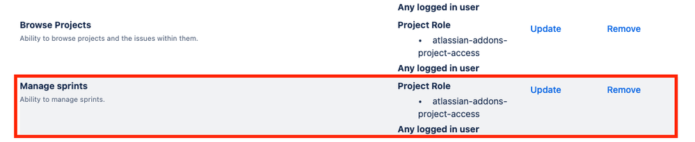

9. The permission you may need to modify is the Manage Sprints permission.
You need to make sure that the people who should not be able to manage sprints don't belong to any of the groups/roles/etc. noted here as having the permission. This may require you to change the groups/roles/etc. that have been granted the permission. In my sample image the permission is granted to Any logged in user. Every user that logins in would be a member of that group. It would be necessary to Remove that group from the permission and then add other groups or roles to the permission if there are people that should be allowed to manage sprints in the project.

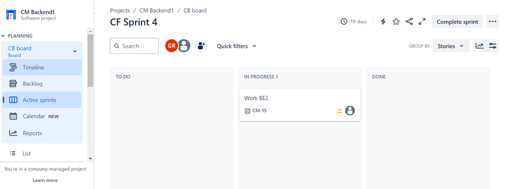

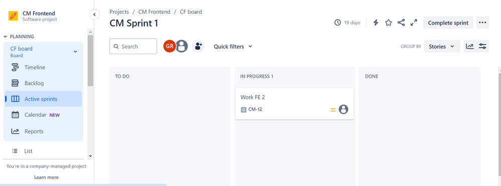

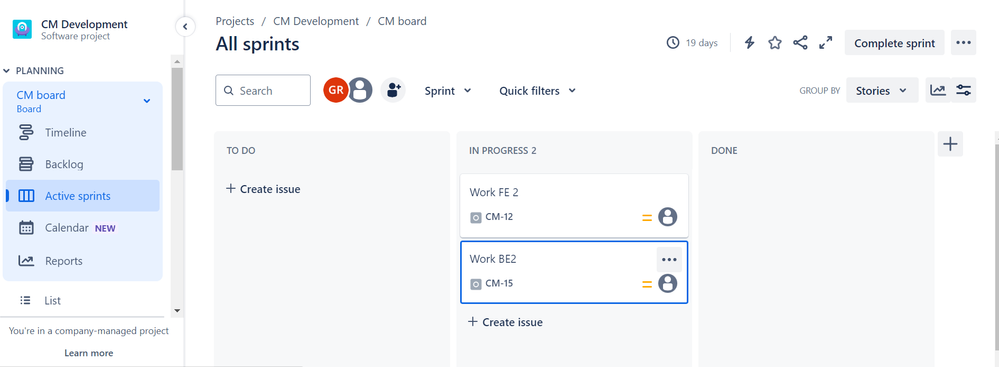

I have completely removed the permissions for managing sprint on CM Development board and yet I am able to access the sprint board and move issues from card to card. These issues are assigned to frontend and backend teams and here on CM Development I just want to see active sprints at max and not be able to complete sprints on CM Development at all.

Are those screen images of your own access or of what is seen by the PMs that use this project?
To what Roles in the project have you assigned the PMs?

CM DEVELOPMENT board is for the project managers and I don't want the PMs to disturb or handle the sprints. But if you can see the permission board I have not given the permission to anyone to manage sprints. But still I was able to move tasks on CM DEVELOPMENT board.
Basically, on CM DEVELOPMENT board the PM must be able to see the sprints running on different boards.

I tried removing all the access from Transition Issue and I was unable to move anything at all. That was good.
But for the CM DEVELOPMENT Board when I turn off everything for Manage Sprints still I am able to click on complete button sprint. Is there anything that I can do where people on DEVELOPMENT board don't have any authority to click on complete sprints button?
When I set restrictions on Transition Issue on CM DEVELOPMENT board that is also affecting the other 2 boards linked I think it is because they are linked with queries. Although, the CM DEVELOPMENT is on a different permission schema than the other two.
Please let me know if disabling the complete sprint button is possible?
Is there a way where we can apply these restrictions to just the main board and not to the boards that are linked to this with queries?

September 4, 2024
Hi @John Funk
I have created a Main Board names Development Board (Company Managed). Here all the backlogs are added.
I have created 2 Company Managed boards and Backend Team 1 and Front End Team and enabled filters.
Backend 1 ->
project = "Backend Team 1" or (project = "Development Board" and assignee in membersOf("backend 1"))
Front End Team ->
project = "Front End Team" or (project = "Development Board" and assignee in membersOf("Front End Team"))
Now, whatever the issues are entered on Development Board and assigned they are appearing on Backend and Frontend boards respective. Although, I don't see subtasks appearing on respective boards until they are run on sprints. Now, how to make that
 sure that the sprint cant be run on main boards but the PM sitting on the main board can have access to see consolidated boards.
