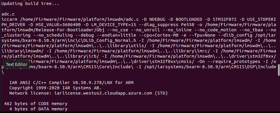

See the output from bitbucket pipeline.  It almost seems like the command is missing a return key or is waiting on something to continue. I've uploaded a screenshot of what happens when I run the same command on my local docker container.
