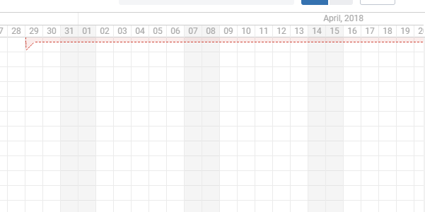

I'm trying to remove this dotted red line on this gantt chart. Is there any way to remove this without an additional plugin?

Hi Logan,
The red-dotted line (orange-dotted in newer versions) indicates the position of the parent task after it is recalculated based on its children. This happens when manual mode is enabled or the issue is locked.
You can read more about task modes here.
