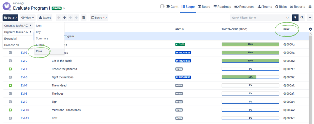

As for the Board module, I'd try adding the Rank column to a view, and then you can sort by rank, as evident in figure #1.
Fig. 1

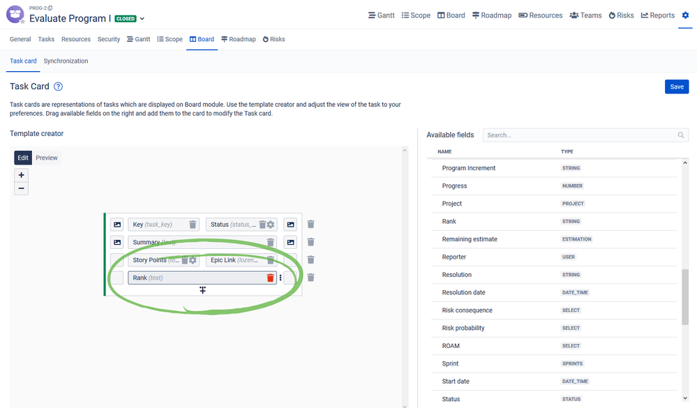

Regarding the Board module, try adding the 'Rank' field to the layout of your Task card, as fig. 2 shows.
Fig. 2

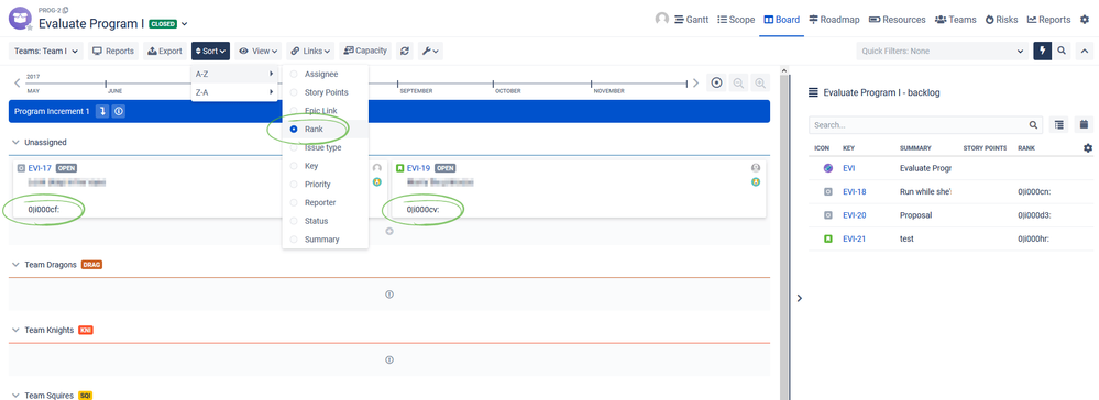

Consider adding the Rank field in the Board's backlog, too.
Try sorting by Rank.

For the list on the right in that screenshot of the Board directly above this, I can see the rank field. Is there a way to sort by it? So that list on the left is sorted the same way they are sorted in JIRA?

Hi @Laura Richardson
When it comes to sorting possibility within the Board Backlog list, this currently is something that is not available I am afraid, however, we do have plans to improve this functionality in our product, so that sorting will be applied by clicking on the column header. Please kindly take a look at the task created on our end to implement this functionality (you may want to use browser incognito mode to access it):
https://jira.softwareplant.com/browse/ONE-4346
Currently, the task order in the Board Backlog is based on the order of tasks from the Gantt/Scope modules in BigPicture. I also highly recommend taking a look at our documentation page dedicated to this very topic:
- Board Backlog
I hope this helps Laura.

Laura Richardson
March 19, 2021
Awesome! Sorting by those helped. It would be good to be able to sort them separately as they may need one sort for planning, but another for the Gantt. But getting planning started helps. Thanks so much!!
