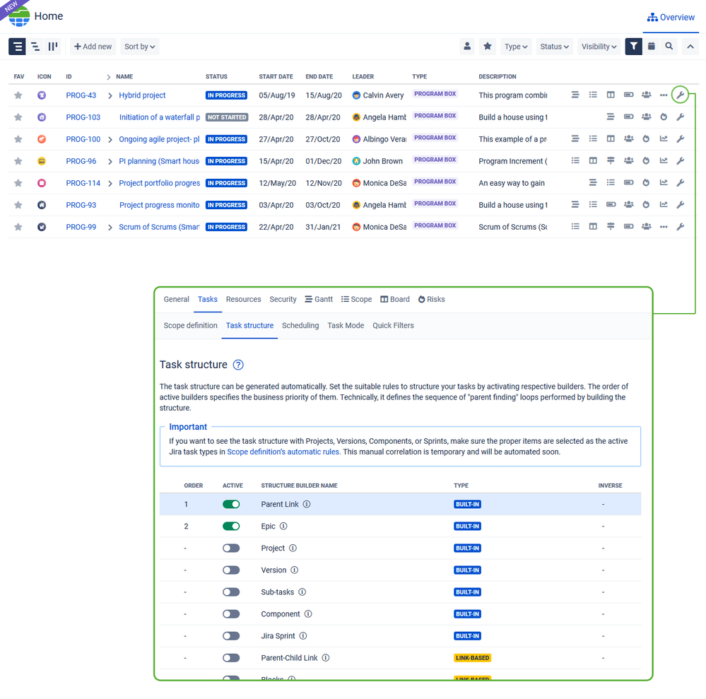

Try the program's administration -> Tasks -> Task structure. Experiment with structure builders, as in the example below. Drag and drop them.

This might be due to the Portfolio parent link. Try using a different link (any Jira custom link will work, just make sure it is not used as the Gantt link in Technical configuration > General > Link configuration. Link your Portfolio Epics with your Epics using this link and activate the Structure builder based on this link. Place it on top of the structure builder links (replace the Portfolio one).
Note the 8th of May, 2017 comment here https://community.atlassian.com/t5/Jira-questions/Why-aren-t-parent-links-being-recognized-in-Portfolio/qaq-p/580611
If that doesn't help, please e-mail us at support (a) softwareplant.com, and specifically ask for a call to be scheduled, and we'll try to set it up on your instance.
