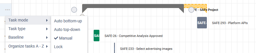

What cause the yellow lines like the following and how can they be removed
Marcin Geb _SoftwarePlant_
Atlassian Partner
May 15, 2020
Hi Scott
The yellow markers result from the task being in manual mode. Once you switch that task to any other mode (typically Auto bottom-up), the yellow markers will disappear.

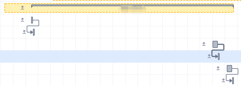

Hi Marcin,
I set the Task mode to Auto bottom-up but still see the yellow warning, do you have any idea? Thanks a lot.
Adam _SoftwarePlant_
Atlassian Partner
August 4, 2021
Hi @Apple
The yellow warning bar is displayed once the parent task in the hierarchy has not enough date range, to cover all of the child tasks which are assigned to it - this way the app shows you just how much longer you must extend the parent task period. To get rid of this indicator, please adjust the task period.

Hi @Adam _SoftwarePlant_ I'm afraid it may be a bug, the yellow warning has been gone w/o any modification. I'll be back if this problem happen again. Thanks a lot anyway.

Hi @Adam _SoftwarePlant_ I can't remove the yellow waring again, do you have any suggestion?
Period mode is auto-bottom up.
Apple
August 9, 2021
@Adam _SoftwarePlant_ I can reschedule the task bar and remove the yellow warning after zoom in into Daily viewpoint. Is this my special case or an known issue?
