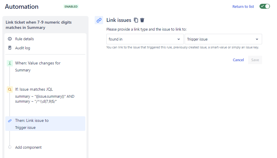

Hiya @Trudy P Claspill many thanks for your suggestions. So glad it can be done.
After experimenting, I did a test with both issues has a summary "test 12345678 test" but both issues have no not linked together. Did I miss something in my rule?
The IF step is a Condition. A Condition checks to see if the current issue meets a condition. In this case you are checking that the issue that triggered the rule has a 7-9 digit string in its Summary. This type of step does not look for other issues that have the same value.

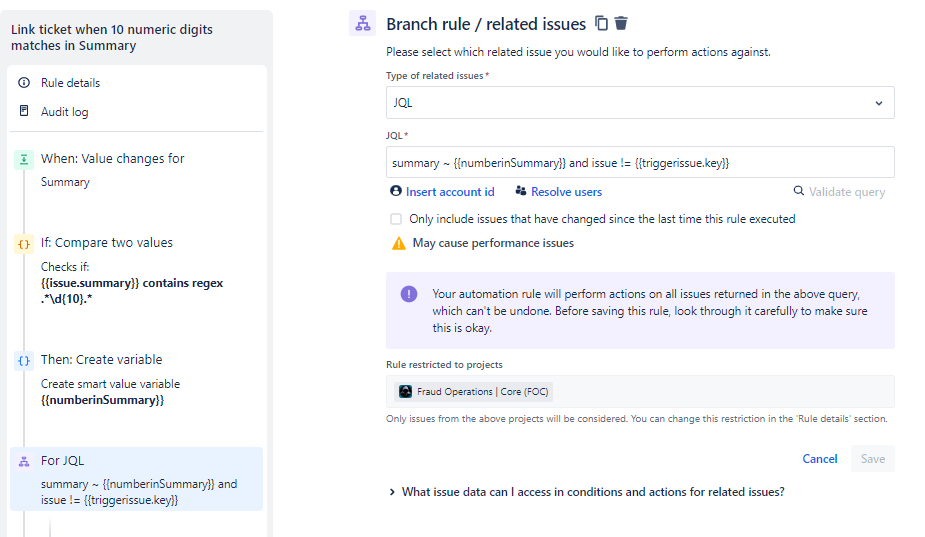

For Branch / Related Issues / JQL
create a JQL that searches for other issues with the same numeric string; i.e.
summary ~ {{variableName}}
Action: Link Issues

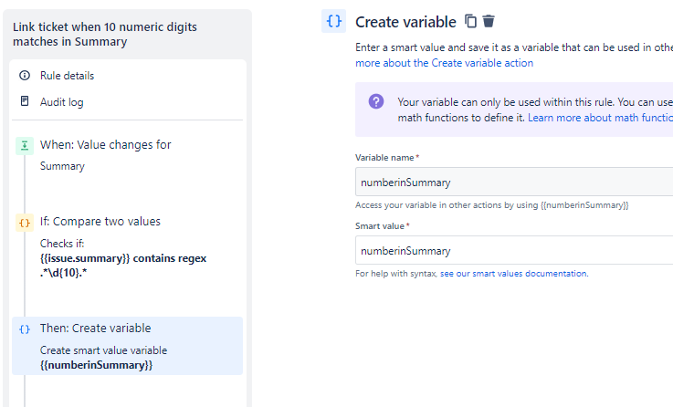

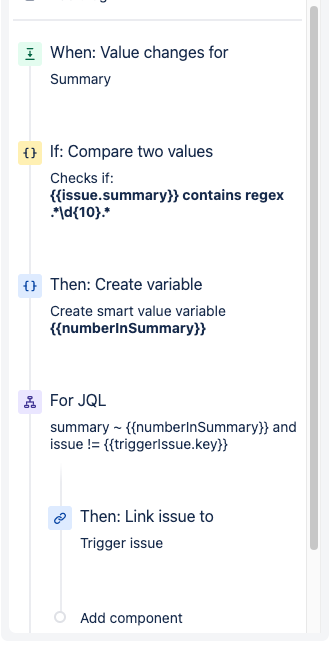

I did not manage with the above, when you have a moment. Is it possible to post a screenshot in your convenient time please?
I used 10 as the number of digits I wanted to match.

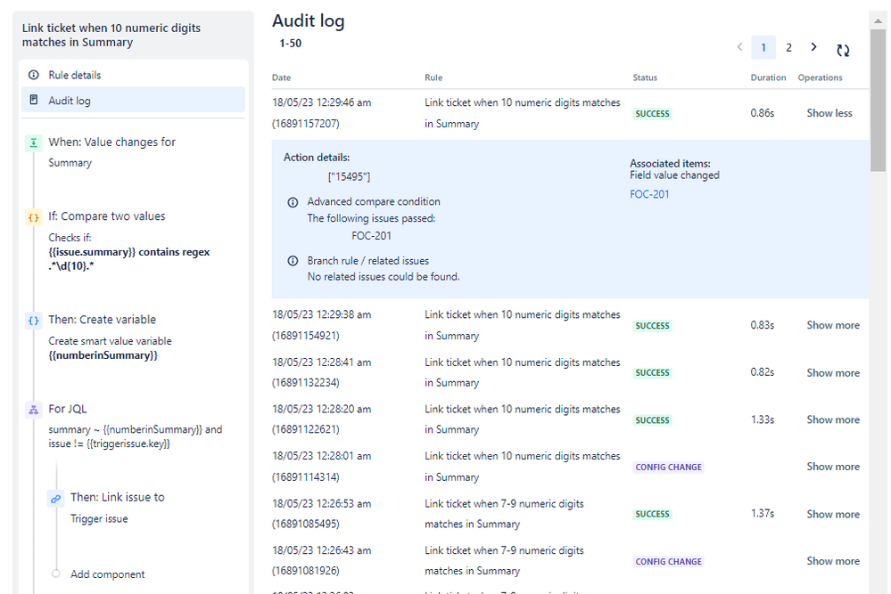

Thanks Trudy, just tested the rule seems success but it said no related issues could be found. However 2 of the ticket got 10 digits the same so they should be linked automatically but it doesn't. Could you have a look and see what did I missed please?

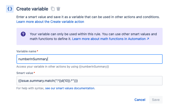

Your Create Variable step is wrong. You need to set that variable to the 10 digits that are in the Summary of the trigger issue.
{{issue.summary.match(".*(\d{10}).*")}}
Cool, Trudy. It works beautifully. :) :)
