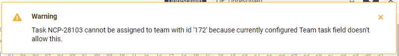

I have created a team with myself as a member in Big Picture. I see the tasks assigned to me in the "Resources" view, but when I try to add the team I get the error message below. Any ideas?

The most probable reason for the warning displayed is a change in the Team field configuration. I need more information to diagnose your problem properly and introduce a solution.

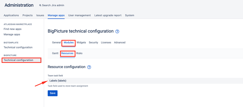

Let me add a short summary for other users. The base on proper Team field synchronization between Jira and BigPicture/BigGantt is a mapping. You can set it up in Jira Administration >> Manage Apps >> BIgPicture Technical Configuration >> Modules >> Resources.
image-2020-12-16-16-51-12-325.pngTeams by default are mapped to Labels type of field; however, you can change the mapping to a dedicated custom field (Select List - single select).

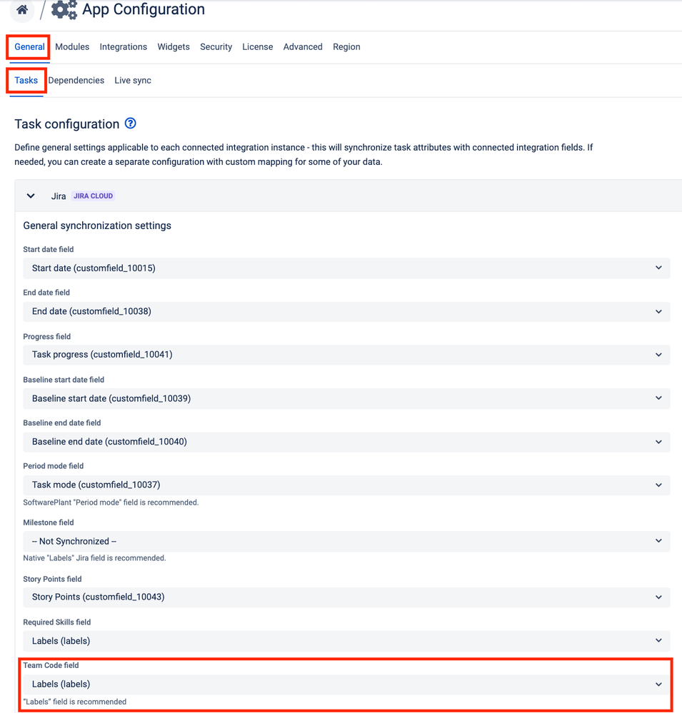

I have the same issue. Did the mapping go somewhere else or is it just for the Server version? Because in my Cloud version there is no Team-field configurable under the mentioned path: Jira Administration >> Manage Apps >> BIgPicture Technical Configuration >> Modules >> Resources.
Just a slider about "Absences are self-managed". Nothing else.
Is it not possible to map it on Cloud?

BigPicture uses the “Team task field” to create a bridge for information and store Team codes assigned to tasks on Cloud as well.
You are right; the Team-field configuration has changed its path. Now you can find it in the General configuration section, Manage App >> General >> Tasks. See my image as a reference.
