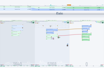

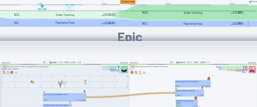

That trade-off is the gap we work on at Everview (disclosure: I'm on the team). It sits on top of Jira.
Jira stays your source of record, nothing migrated and reads your work onto one live canvas where two things are true at once:
  • A platform's work isn't locked to a single sprint. You can push items forward into later sprints as the work genuinely spans them (the thing Jira won't let you do at the subtask level) without flattening your structure to get it.
  • The per-platform picture stays intact. iOS, Android, and Web sit side by side, each showing live progress read straight from the actual Jira issues (every card is a real issue, carrying its real key), so the at-a-glance "which platform is where" view survives the exact thing flattening would cost you.
One honest caveat: it won't magically make a Jira subtask hold its own sprint — that limitation is Atlassian's. What it does is give you a planning-and-progress surface where the per-platform grouping and the multi-sprint spread coexist, instead of you choosing between them.
Screenshot 2026-08-13 at 11.48.39 AM.pngScreenshot 2026-08-13 at 2.55.07 PM.png
The sandbox is open if you want to see whether it fits your structure (no signup) and it's on the Atlassian Marketplace if you'd rather try it on your own instance: Everview.ai
