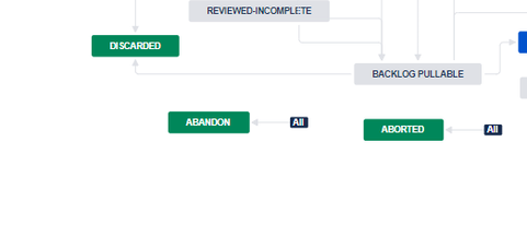

John Funk
November 16, 2020
Here's a screenshot of part of our software development workflow. Done is another status used elsewhere in the same workflow.

Thanks.  Do you leave these cards in the backlog and filter out from there?
John Funk
November 16, 2020
They don't go to the Backlog - they are in a "Done" status category (like the Done status) so they do not appear in the board anywhere. The exception would be that the Abandon status clones a new ticket and places the new ticket in the Backlog to be worked later.
