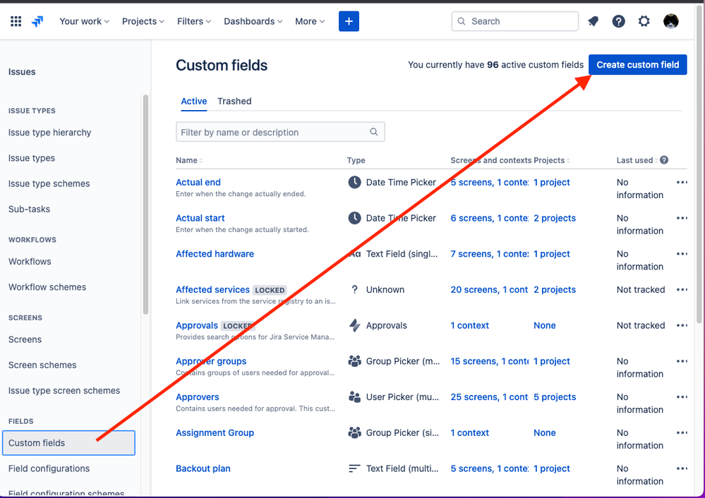

You don't actually need to create a Company Managed project. You just need to create a Custom Field that could be used in a Company Managed project. Such fields are created from Jira Administration > Issues > Custom Fields.
Custom Fields that can be used in Company Managed projects are created outside the scope of any individual project. They continue to exist even if they are not used by any project, unless you explicitly delete them.
