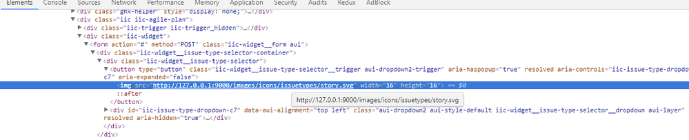

when loading pages thoughout jira, im having issues loading certain assets as jira create the html with wrong urls, i checked and the baseurl in settings is correct..
why its using http://127.0.0.1 instead of https://jira.baseurl?
also is it possible to load relatively? without the prefix of https://url/

What do you have in your /<installdir>/conf/server.xml?
And you did set the baseurl in the general configuration, correct?

When i first setup Jira it asked me for the baseurl so i gave it my url.
Also server.xml is the generated default i guess:

Josh Steckler
July 14, 2017
In your <connector> attribute, you need to add a few things for the proxy to work.
Here's what it should look like:
 <Connector port="9000"
maxThreads="150"
minSpareThreads="25"
connectionTimeout="20000"
enableLookups="false"
maxHttpHeaderSize="8192"
protocol="HTTP/1.1"
useBodyEncodingForURI="true"
redirectPort="8443"
acceptCount="100"
disableUploadTimeout="true"
bindOnInit="false"
scheme="https"
proxyName="jira.baseurl.com"
proxyPort="443"
secure="true"
lihaibh
July 14, 2017
It works! thank you
