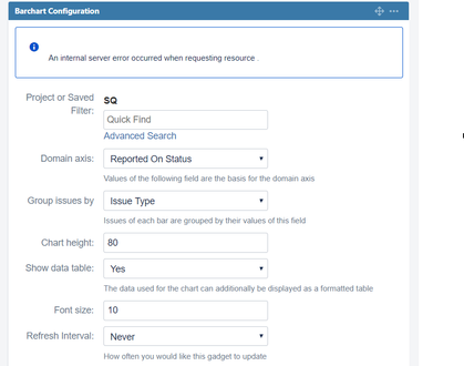

Hello Team,
I have simple filter to show on my dashboard using 'Bar Chart Configuration' gadget, I cannot save/show the configuration because of this followed error 'An internal server error occurred when requesting resource'.

Teja
November 4, 2019
Hi @Petter Gonçalves -
I would like to thank for your time to help resolve this issue.
Yes, 'Barcharts for Jira' plugin is third-party app.
I have tried all 3 above steps but didn't work.
When checked in the developer console I see this error in the browser.
Failed to load resource: the /rest/barcharts/1.0/BarChart/GenerateChart?projectOrFilterId=filter-24924&axisField=15508&groupField=-4&width=549&height=439&_=1572862123741:1 server responded with a status of 500 ()

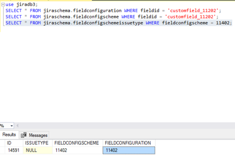

Teja
November 5, 2019
@Petter Gonçalves
1. I have ran the integrity check and found no errors.
2. I followed the KB of Corrupted Custom field, and I found same id for  FieldConfiguration and FieldConfScheme so couldn't able to replace.
Am I missing anything?
