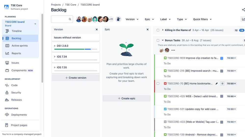

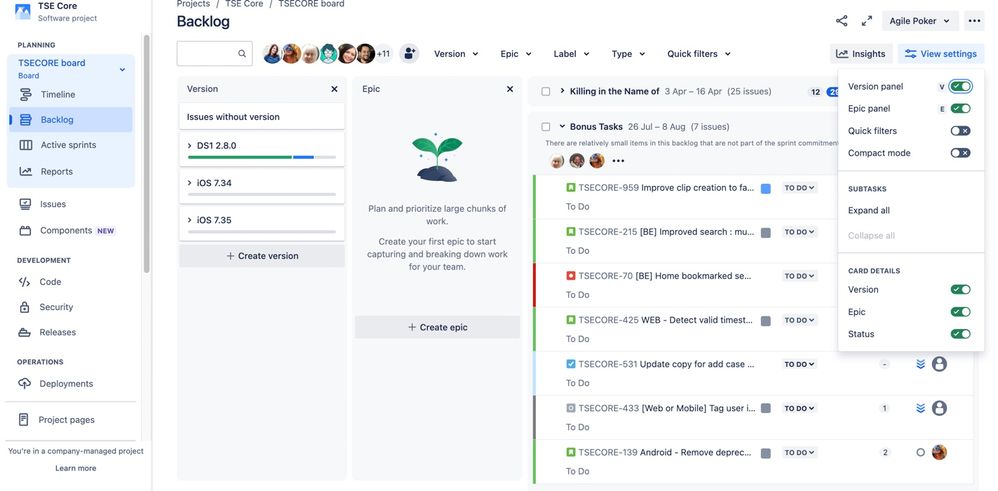

I am struggling to create Backlog list of Epics which will be displayed on the left hand side of the project. I have tried turning the epic toggle on but nothings happens. Epics are visible in active sprints planning view but weirdly not in the backlog view.
Could you please advise on what to do?

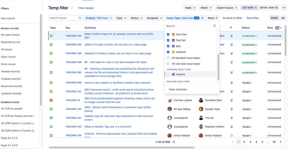

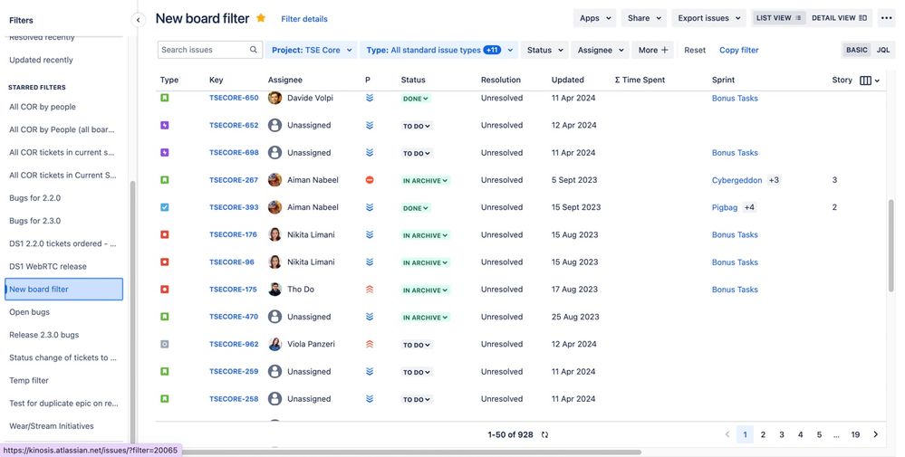

Been trying to adjust the filter adding epic and initiative 066B9EBB-E3A8-4A68-B966-DBEA19FDD987.jpeg
no changes applied to the side pane in backlog - version is displaying though - so wondering how I can get to that view. Any ideas?

A couple of things to check: I see you marked epic as an issue type in the issue navigator view. In your screenshot, I don't see any epics reflected (it's possible that they are in the list, but not on the screenshot - I know. But still: make absolutely sure that they ARE being returned by the filter.
Next, also SAVE that filter to make sure the updated selection gets reflected on the board. To make 100% sure that your epics are included, check your board configuration > general and ensure that epics are really part of the JQL statement that you see there.
As from that point onwards, enabling the epics panel should indeed display your epics. If you still aren't getting there, it might help if you could share a screenshot of the general tab of your board settings.

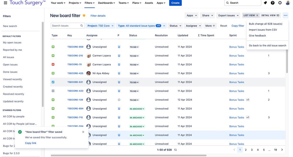

I've saved the filter as "New board filter" (screenshot 1) and epics they are returned once applied (screenshot 2)2EAC1B8E-CFCF-482A-B198-CDEAE62C693B.jpeg
Again, nothing gets reflected in the backlog view>side pane

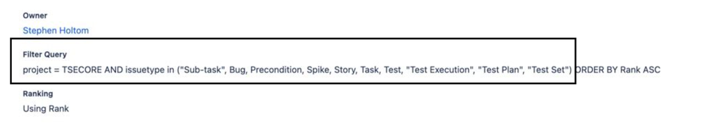

As requested, I'm also sharing the screenshot of the general tab of my board settings. Thank you for your help.

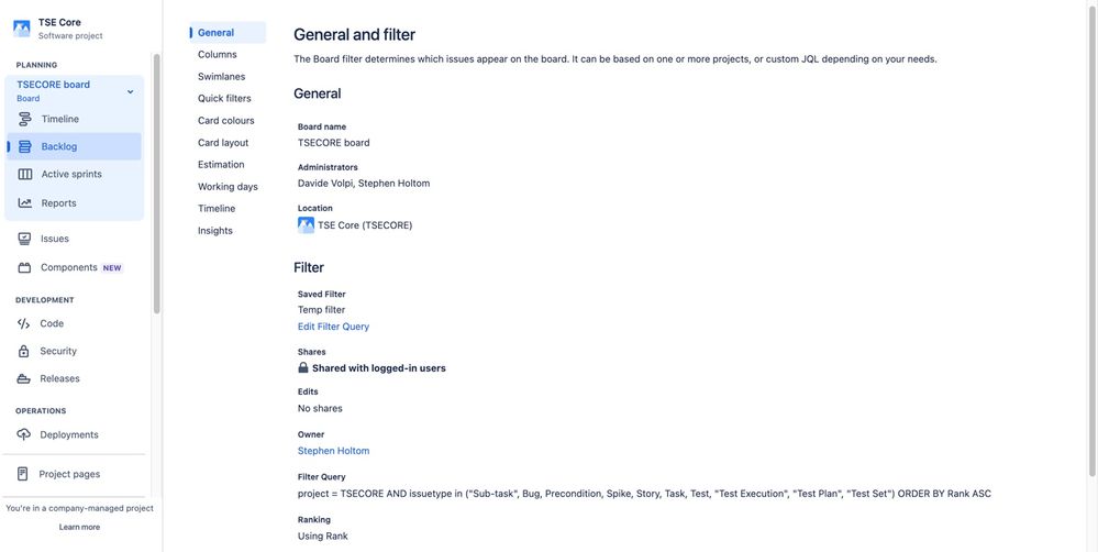

Hi @Viola Panzeri, no - but now we're getting somewhere: as you can see in your last screenshot, epics are still not returned by the filter behind your board:
Screenshot 2024-04-12 at 14.52.49.pngIf you replace the board filter with one that does indeed include the epics, you should be fine.
