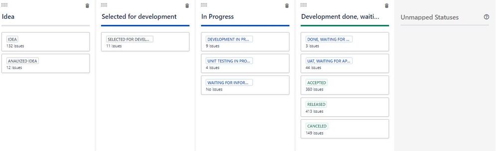

We have an issue where some of our development tickets are not showing in the Backlog.
The board's filter query is as follows: project = <PROJECT> ORDER BY Rank ASC
Columns:
columns.JPGAs you can see, we have a 144 tickets in either "Idea" or "Analyzed idea" status. But, we only have 82 tickets in our Backlog:

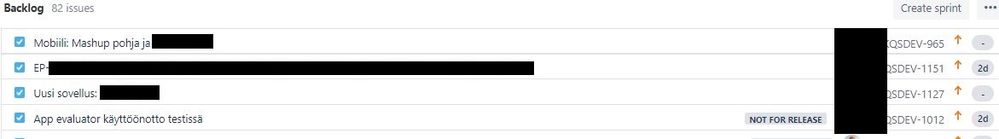

If I perform a search with the boards filter (project = <PROJECT> ORDER BY Rank ASC), all issues can be found. For some reason those same issues are not visible in the active sprint view.

There are five different statuses in the "Development done, waiting UAT" column: "Done, waiting for review", "UAT, waiting for approval", "Accepted", "Released" and "Canceled". From those five we have two statuses that actually show in our board: "UAT, waiting for approval" and "Accepted". We would like to have the status "Done, waiting for review" shown in the board as well, but I'm unable to find a way to add it there.

As this is a Scrum Board, the backlog will show any issue which is not completed in a sprint (complete is defined as any statuses mapped to the right-hand column) and not in the active or a future sprint.
Can you confirm if any of the issues in "Idea" or "Analyzed Idea" have a sprint set against them?

In regards to your second question, you have the statuses mapped - but this doesn't change your workflow.
This means if you need to be in "Accepted" before you move to "Released" - it will only be an option for drag/drop on the board for issues already in "Accepted". It also means if this is the case you'll need to have "Released" in a different column to drag the issue into - you cannot drag between statuses in the same column.

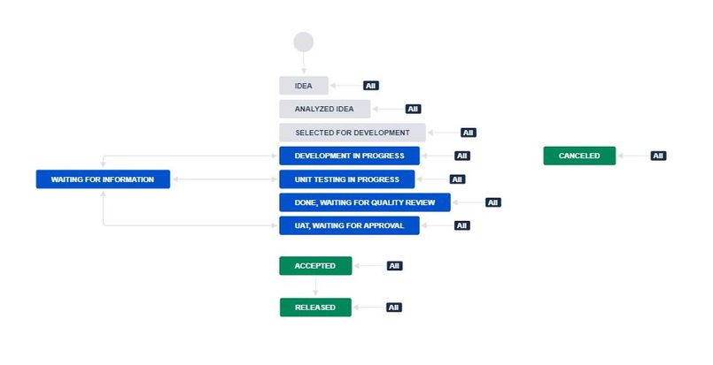

Regarding the second part. Here is our project workflow:

Did you notice in your status mapping that some of the status category types (To Do, In Progress, and Completed) do not match the columns on the board?
You can see that from the color coding: To Do is gray, In Progress is blue, and Completed is green.  The left-most column should be To Do status values only, and the right-most should be Completed status values only.

Yes I have noticed and I agree that the grouping is "off" with our project. Anyhow it's mostly working as intended and we can see issues in the status "UAT, waiting for approval" (which is an 'In progress' issue) in our sprint boards regardless of that status being in the 'Completed' column. At the same time the other 'In progress' status "Done, waiting for review" doesn't show on the boards. This is puzzling me.
