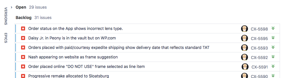

We have instructed our Backlog Kanban Board to hold only Backlog tickets, but upon opening it, it has both Open and Backlog tickets.
Desired outcome: Backlog Board only has "Backlog items" and not open. It should just have tickets that were just created.

@Bill Sheboy you can see that the backlog should have just pending confirmation, but upon opening, it has both that and open

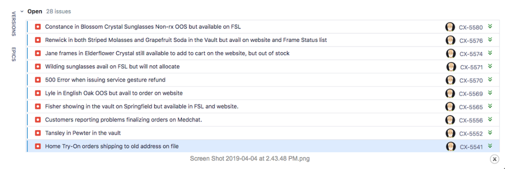

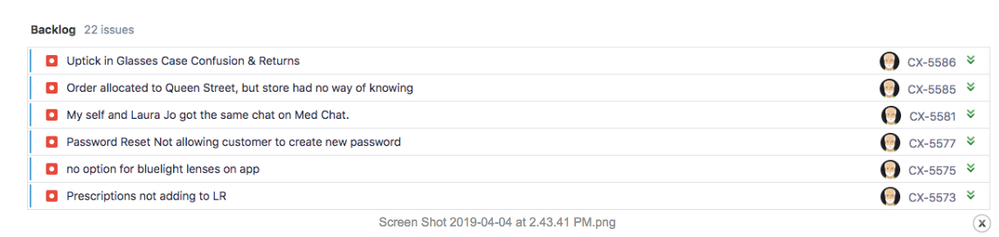

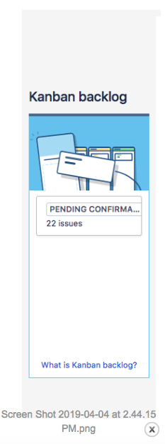

Attached are the two screenshots you want. It's fine to collapse the open section, but this board is viewed by 500+ individuals and want to make it as easy to view as possible.
Thank you for the additional screen images. Short answer: I do not believe there is a way to remove Open from the backlog view.

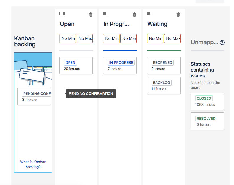

The Jira Kanban backlog view shows items from your "backlog" status (Pending Confirmation) and the first column of your actual board: Open. The purpose of showing both is so you can move items from the backlog into the first column of the team's board when the team is ready to select them.
Would you please post an image of your board configuration, including which status values are mapped to which columns? That will help in determining what's up. Thank you.
