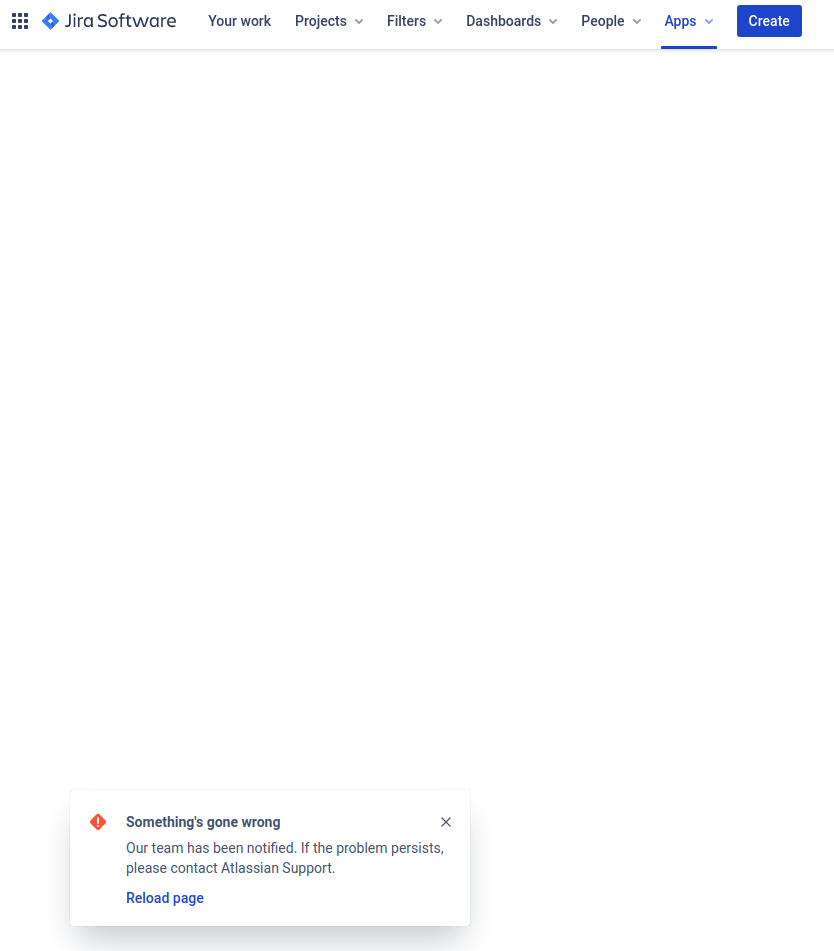

Actual result
Page stays loading for a while, ends up erroring:

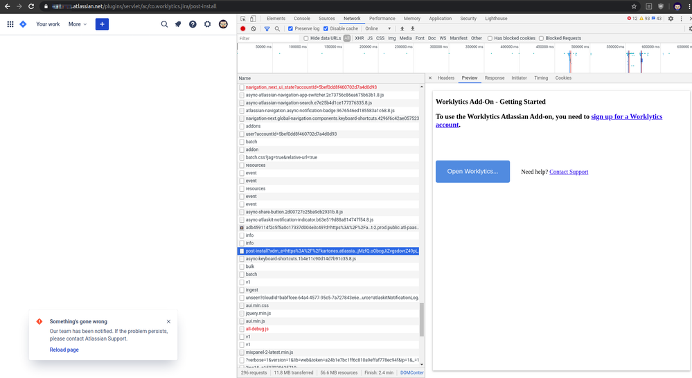

Inspecting the network calls, the post-install call to the application succeeds, and if I preview it and click on the "Open Worklytics" the app connection is performed successfully.
But up in the network calls there's one 404 error:
Request URL: https://xxxxxx.atlassian.net/rest/api/latest/user/properties/navigation_next_ui_state?accountId=yyyyy
Request Method: GET
Status Code: 404
Body:
{"errors":{},"errorMessages":["The property navigation_next_ui_state does not exist."],"httpStatusCode":{"present":true}}
So while the connection is fine, looks like the UI breaks and doesn't renders the post-install iframe.

August 25, 2020
Self-answering myself: After some debugging, the issue was in our `all.js` (to be specific, `all-debug.js`), it should no longer be hosted as a subdomain-based file, but instead use Atlassian CDN (see https://developer.atlassian.com/cloud/jira/platform/about-the-javascript-api/).
Once I updated the url to the CDN one, it worked fine.
