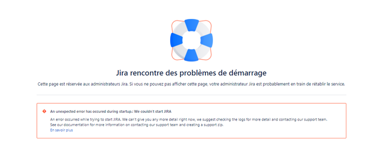

We have big problem and we can't acces to jira even to an account jira repertory user.
No change no update no action was did.
And all sql messages:
Caused by: com.microsoft.sqlserver.jdbc.SQLServerException: Le journal des transactions de la base de données « connecttojira » est plein en raison de « LOG_BACKUP ».

Below is the error message when logging into Jira:

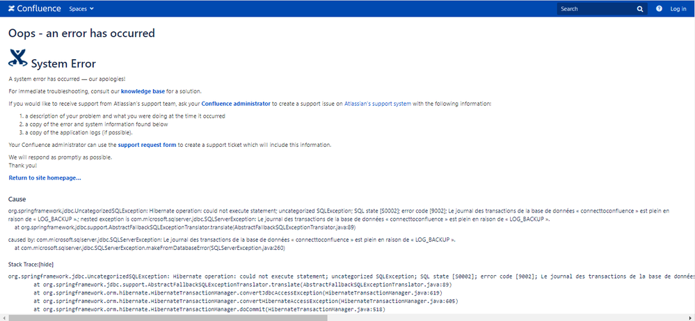

On confluence we have also some errors :
But the public part of Confluence still working perfectly (it's knowlege base for user)
