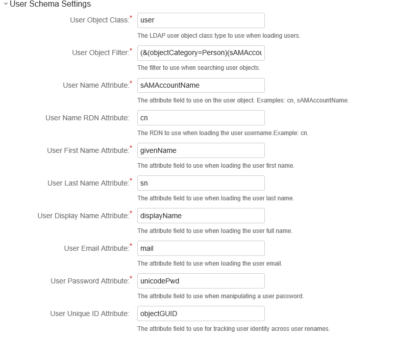

I’ve been working with our IT engineer responsible for Azure to implement SSO in our Jira test environment. I first had to work through some of the prerequisites in accordance to the Microsoft instructions. For reference, we are on Jira Server 7.2.7.

Our Jira instance is configured to get directory info from a local LDAP server. User Schema settings are pasted below. The exact attribute of sAMAaccountName and objectGUID do not appear in our Azure configuration according to the IT engineer. He’s used onpremisessamaccountname and objectid as substitutes during the various configuration attempts. I’ve also tried setting the azure configuration for userid to various attribute values including the onpremisessamaccountname. When I manually point the userid reference to an attribute then the login error changes to attribute not found in SAML response packet.

This effort stalled once our IT group renewed the contract with our current SSO provider for another year. It is about to pick up again (tomorrow actually). We believe the issue was that our on premise Jira server uses the LDAP objectGUID as the unique user attribute. Our IT/Cyber teams didn't map this attribute into our Azure cloud system. I believe the solution will be for them to do so so that we can reference it in the SAML settings and they can reference it in the Azure Jira SSO config. Otherwise, it appears that reassigning the objectGUID to another value in Jira (while maintaining user associations with issues/roles/etc) is a bit of a lift requiring SQL and temporary mapping tables.
