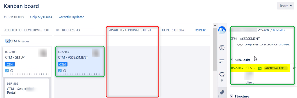

I'm facing a strange issue or bad configuration on a Kanban board. Subtasks with "awaiting approval status" are not displayed automatically in the column "Awaiting approval".
The only way I found to make them appear is to edit them (by adding a comment for example).
An example in the screenshot below. Nothing in the "Awaiting approval" column. While the main ticket is "In progress" (left) and in the detail of the ticket we can see the subtask is on "awaiting approval" (right)
If anyone has an idea... Any help will be appreciated. Thanks!2021-09-27_15h00_43.png

By the way, I have another question that might help or be related to the problem. The approval column shows me:
AWAITING APPROVAL
5 OF 20
Where are the other 15?
P.S: The portal filters catch the subtask. So they are here but not displayed.

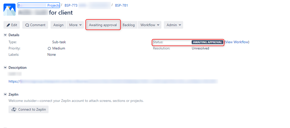

Maybe it is related to the Worflow or the status? For example (sreenshot below), in a subtask that does not appear. It is in "Awaiting Approval" status. But if I click again on "Awaiting Approval" next to "backlog", it appears in the list.
Jack Brickey
September 28, 2021
I find it interesting that the “awaiting approval” button shows on the screen if you are already in that status. Can you investigate your workflow transitions an see if you have different “awaiting approval” transitions?

In the Kanban board configuration, there is an option called "Hide completed issues older than". You can select 1, 2, 4 weeks or show all.
For example, if a ticket has not been updated/edited for 2 weeks, it is hidden. That's why as soon as you make a modification, the ticket reappears.
If I select "show all", all my ticket on status waiting for approval finally appears!!
