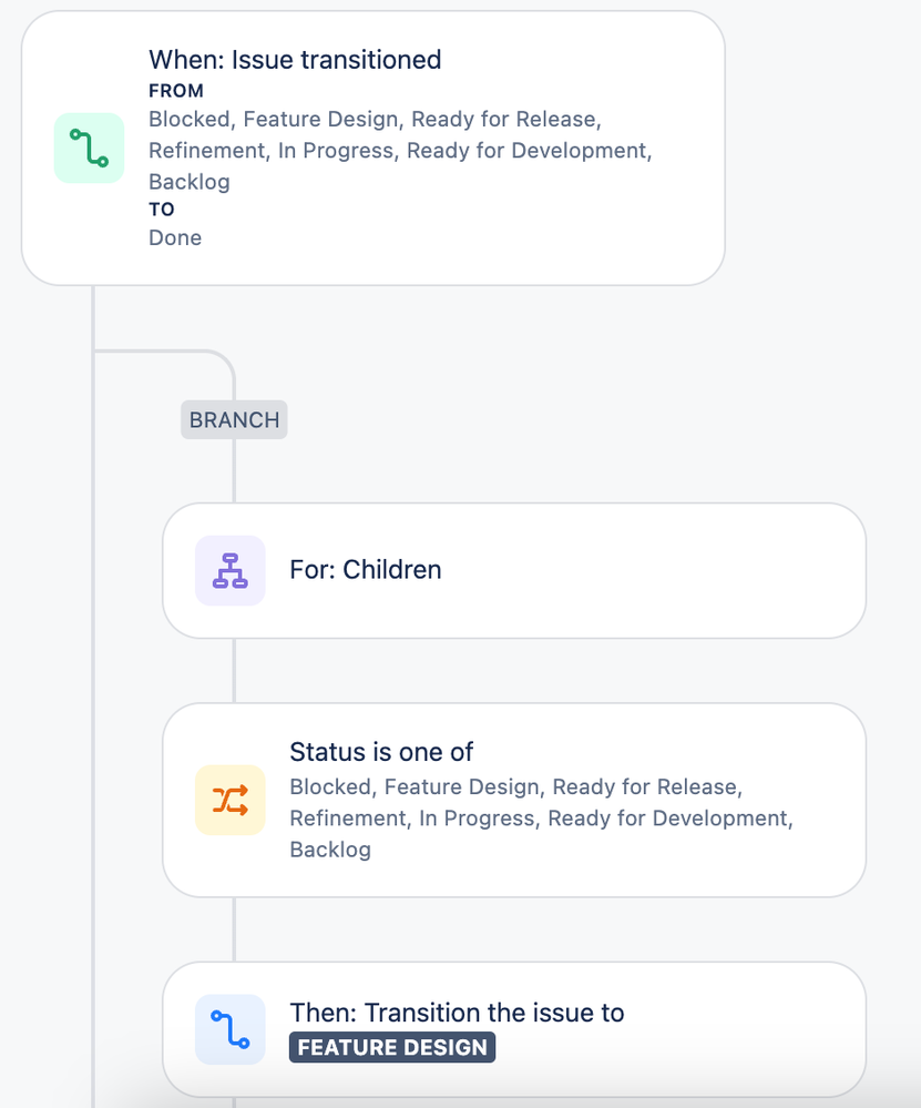

I created an Automation to avoid closing an epic when not all child stories are also closed but it doesn't work.
Also I tried doing it through a transition and also didn't work.

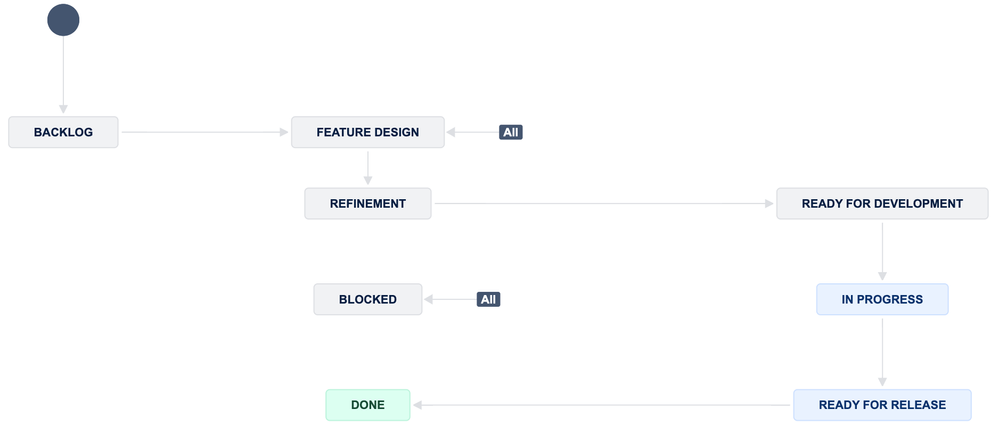

This is my workflow:

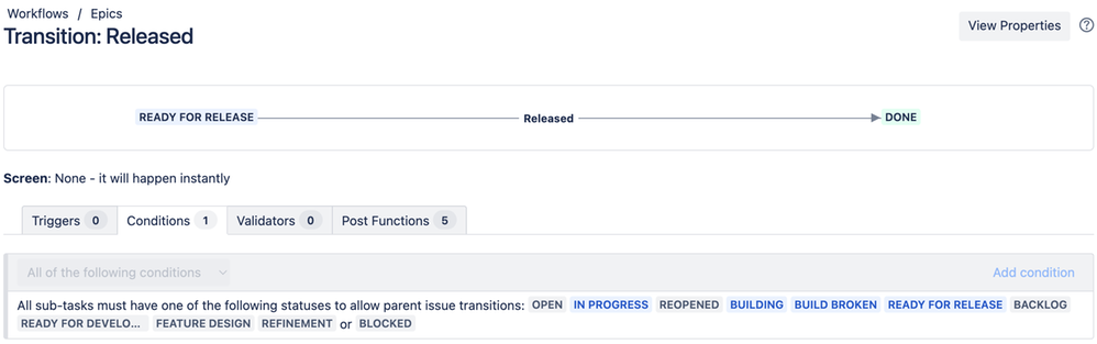

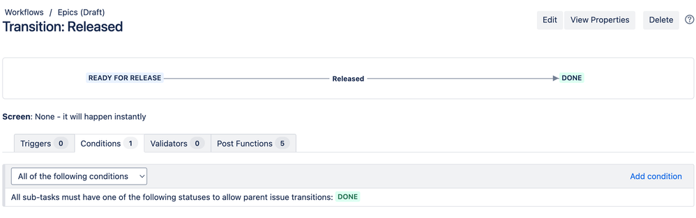

This is what I've done in the transition:
Besides my intention to avoid the transition to DONE, is to pop up a message letting know why the transition is not possible or avoided.

Mathew Lederman
December 19, 2024
@Cristóbal González I believe your workflow condition is backwards. All sub-tasks should be in a Done status to allow the parent to transition.
Cristóbal González
December 19, 2024
Thanks @Mathew Lederman
I made this change:
But still not working

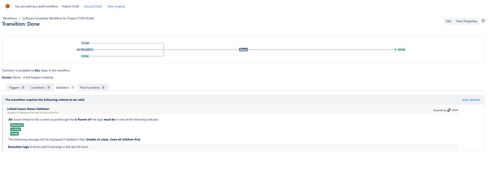

  1. I modified the workflow and added a validator to the transition to "Done."

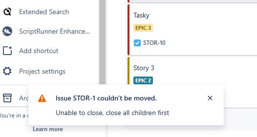

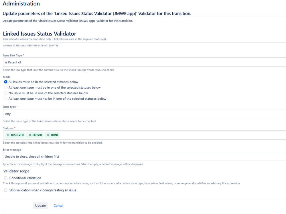

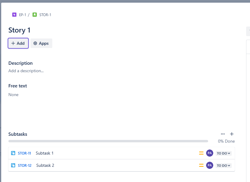

  2. The validator checks the issue before transitioning:
    • It validates the linked issue type "is Parent of."
    • Uses the condition "All issues must be in the selected statuses."
    • You can limit this to specific issues or, as in my case, apply it to "Any" issue.
    • Select the desired status(es) that the child issues must be in.
    • Specify an error message to display if the criteria aren’t met.
This ensures the issue transitions only if all validation requirements are fulfilled.
