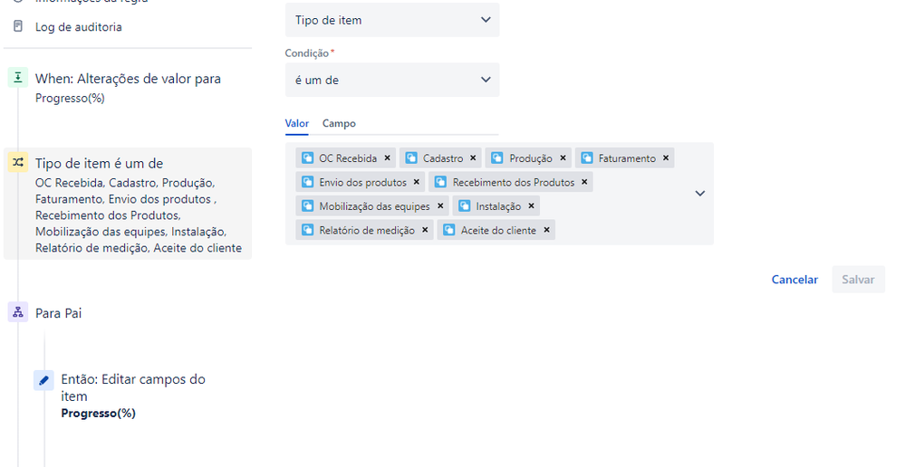

I tested the smart value and its worked good, but the trigger is the problem, i used in this way how on the picture.
but doesn work.

Douglas Oliveira
October 11, 2021
I get finded the trigger error, Nothing happens because the field "Progress(%)" is changed by a other rule when i chang other field. I needed of add other fields for my Trigger

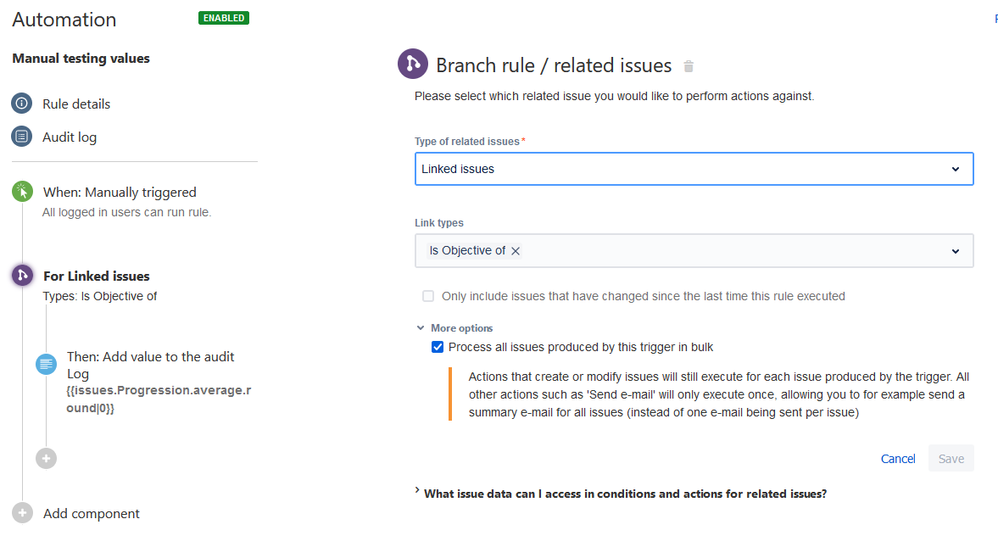

Instead of Lookup Issues, the Server/Data Center version has a "bulk handling" option that can be used for a branch (or scheduled trigger with JQL).  Just select that option and then use the {{issues}} smart value.  Note that name is plural, indicating it is treating the results as a smart value list.  The same functions should work with that list.
https://confluence.atlassian.com/automation/bulk-handling-of-issues-993924653.html
Bogdan Gorka
March 10, 2022
Hello again @Bill Sheboy
First of all, no need to apologize :) I wasted the time first and then asked you for help. However, it was not all wasted, because I finally found the answer to where to find SmartValue names for specific fields. There is an article explaining this here:
And I am very grateful for the hint you gave me about the "bulk handling". This works! With this option on, the result of cycling through the list of issues is treated as a list of values and indeed we can then use some of the SmartValues for lists.

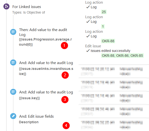

I did some the testing you mentioned earlier and, to be honest, I was disppointed with the fact that log action is written only once but when you put the same value in the Edit action, then it is written in every issue in the loop. I am happy to share the results of my experiments.
Below is the Automation Log result items from the enclosed picture
1. this is the average formula, correctly calculated, taking into account only the issues linked with the link type: "is Objective of" - this is what we discussed earlier that it would be great to get that output outside the loop and put it into the triggering issue.
2. this is the test showing that the log will write only one value, if you use SmartValue "issue" and not "issues". This will take the last issue in the loop into account. If you use issues, the result will be 3
3. this is the test showing that the log writes only the data from the last issue in the cycle, if you use SmartValue "issue" and not "issues".
4. as soon as I put the same formula from point (3) and edit the Description value, so it is action: Edit, field: Description, value: {{issue.key}}, then the automation does that operation three times, because I have three linked issues.
So, I suspect, if I did it with action "Send web request" to use REST API, these calls would happen 3 times as well, unless there is some trick (with the condition?), which will stop the loop after the first linked issue update.
If it happened only once, then it would make sense to use it as trigger for another Automation. Then I could find the "parent" of the triggering issue and copy the value. Not so an elegant solution but it would be good to have it available.
Anyway, this is a very time engaging exercise but expands the horizons and the know-how about Automation.

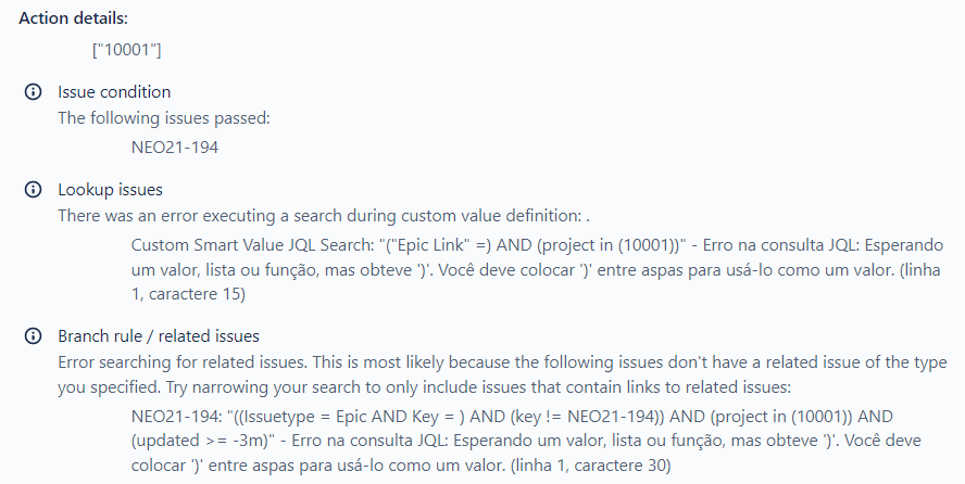

Thanks @Bill Sheboy , using this way I've made some progress but I still can't get the average of the values.
This is my situation at the moment
Bill Sheboy
March 25, 2022
To make the edit, you now want to use the lookup issues result as your source for the issues:
{{lookupIssues.Progresso(%).average|0}}

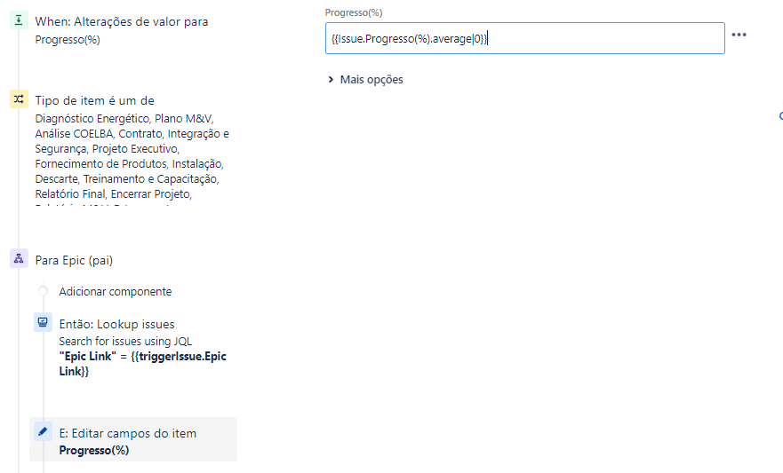

Thank you @Bill Sheboy  it really works and the article is very good, but for some reason I am not able to open the URL of the issue to better understand how to get the smartvalues I will check if it is a restriction of the company's connection. By the way if the trigger of the rule was a subtask within a task that is inside Epic, how could I activate the rule? I was thinking about this because subtasks don't have the Epic Link.
Bill Sheboy
March 25, 2022

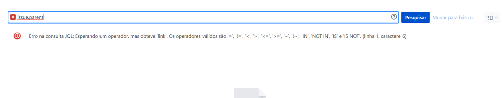

For a subtask triggered issue, you would need to walk up two levels: first identify the parent of the subtask, get that issue to then find the epic link.

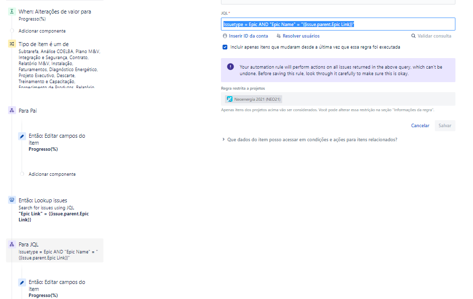

Douglas Oliveira
March 29, 2022

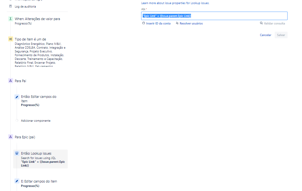

@Bill Sheboy  I tried doing it this way but the calculation didn't work for epic.
I tried to make everything one rule.
I used for parent: {{issue.subtasks.Progresso(%).average|0}}
And for Epic: "Epic Link" = {{Issue.parent.Epic Link}}
Like the picture.
Bill Sheboy
March 29, 2022
It appears you are performing that lookup issues inside of the branch on the parent Epic, and so when it references {{issue.parent.Epic Link}} I do not understand what that could be referencing...and apparently neither does the rule.
That would be something like: for the Epic > parent > Epic.  Which is probably not what you wanted.
To help clarify what you need in a rule, would you please answer:
  • At what level are you manually entering a value for Progress %: subtask, story/task, or epic?
  • At what levels should the Progress % be automatically calculated?
  • For each automatic calculation, what should the value be?  For example, should it be minimum, maximum, average, or something else?

Really this rule doesn't get you anywhere, I modified it earlier.
Well I can do both calculations well but the problem is still the trigger is the subtask since there is no epic link.
I am currently using the following structure:
In lookupissue: "Epic Link" : {{issue.parent.Epic Link}}
And for Branch JQL: Issuetype = Epic AND "Epic Name" = "{{issue.parent.Epic Link}}"
but isnt work.
Bill Sheboy
March 29, 2022
Your JQL in the branch is trying to match on Epic Name and you want to use key in order to get the epic:
issueType = Epic AND key = {{issue.parent.Epic Link}}
Douglas Oliveira
March 29, 2022
Its work Thank you , its the first time that i work with the Epics but i understand more now.

Douglas Oliveira
June 2, 2023
Hey guys,
I'm reactivating this question because for some reason the rule stopped working, showing the error below:
Have there been any recent changes to the Jira schedule?
Note: The rule is the same as the image above, with only the change suggested by @Bill Sheboy
Bill Sheboy
June 2, 2023
Hi @Douglas Oliveira
This seems related to the changes for epics, sunsetting things like "Epic Link" and replaced by parent.
Let's try this...using example issues, try running your JQL manually with advanced issue search.  That will confirm if your site is now using the parent field.  Then adjust the JQL to work correctly, and finally update your rules.
Douglas Oliveira
June 2, 2023
Hi @Bill Sheboy ,
Using advanced search I can't find it anymore "issue.parent"
In this case, value do I have to put to find the epic where the subtask is?
Bill Sheboy
June 2, 2023
Sorry, I was not more clear...
In a rule, you can see {{issue.parent.some field}} because the rule is loading both, but that is not the case with JQL.
Instead, find an example issue that would have been {{issue.parent}} and then see which field is available: parent or "Epic Link".  Then use that information to identify the smart value for the rule.

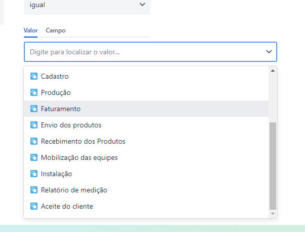

Douglas Oliveira
June 6, 2023
Hi @Bill Sheboy ,
I don't know if I understood correctly, but the field available to me when I search for this type of item is "Epic link"
Douglas Oliveira
June 6, 2023
Sorry the message above ended up being sent incomplete.
I believe it should work, I searched the jira documentation and the smart values used are valid....
