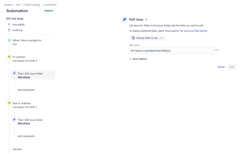

Hello community,
I'm trying to automate a field with a % of time set in the original estimate.
I created a rule that selects the % according to the value of a custom field (X) and i'm trying to change the put the value of that % to the original estimate and feed the result to a custom field (Y)

Houssein Barkallah
October 19, 2022
Thank you for the replies:
I'm trying to provide my team with a secondary estimation.
  •  [System] Original estimate will remain untouched.
  • Custom field (Y) will have the original estimate value + a % that depends on the value of the custom field (X)
Trudy P Claspill
October 19, 2022
So if I understand correctly, looking at the first branch of your rule where the field HLE = "HLE LEVEL 0" then you want to set "HLE wCont" to
Original Estimate + 40% of Original Estimate
In that case the math would be
HLE wCont = 1.4 * Original Estimate
...and the proper syntax to get that in the automation would be like the first example on the page @Bill Sheboy referenced.
{{#=}}{{issue.Original Estimate}} * 1.4{{/}}
Note that Original Estimate is stored as seconds. What type of field is "HLE wCont"? You may need to also apply some conversion in your math to get the number that you want.
Houssein Barkallah
October 20, 2022
Thank you Trudy,
This works as you mentioned.
The HLE wCount is a number field that now stores the number of seconds.
