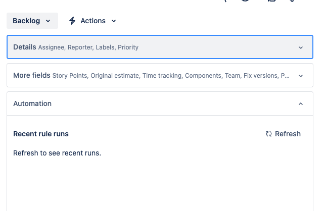

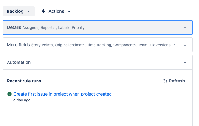

Trudy P Claspill
May 30, 2024
Hello @Abbi Littrell
It is unlikely that an Automation would randomly execute or that it would make updates that do not align with the details of the rule.
If an Automation is executing against issues it should be noted in the Automations panel in the issue.
You may need to click the Refresh button in that panel to display the latest automations.
Does that panel show any rules having been executed?
Screenshot 2024-05-30 at 10.47.59 AM.pngScreenshot 2024-05-30 at 10.48.10 AM.png
You can also look in the global Audit Log to see rules that have recently executed and drill into the details to find which rules are acting against specific issues.
https://<your Base URL>/jira/settings/automation#/tab/audit-log
I would recommend finding the Audit Logs to find the ones that document they are acting against the affected issues. Once you find one of those logs, if you can provide a copy of the log here and screen images showing the full details of the related rule and each rule step, then we might be able to help debug the problem.
