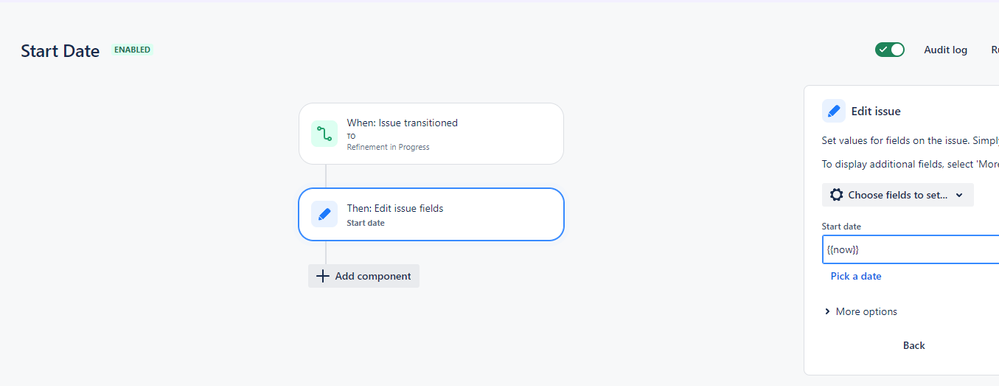

I have two relatively simple automations that work perfectly on their own:
  1. IF issue is transitioned to "REFINEMENT IN PROGRESS" status; Start date = NOW
This works for all issue types that have that status.

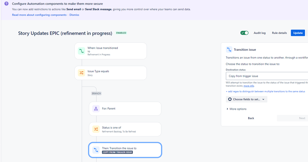

We created another automation to have the EPICS status updated if its CHILD STORY was updated.
     2.  IF STORY is transitioned to REFINEMENT IN PROGRESS, then COPY THAT STATUS to its Parent. This also works perfectly.
However, you would expect when Automation #2 is run to update the EPIC to REFINEMENT IN PROGRESS, that Automation #1 would also fire to tag it with the Start Date...Why is this not happening?  After all, the issue is getting Transitioned to REFINEMENT IN PROGRESS, which is the only condition that needs to be met for Automation #1..  If i go and move the EPIC to REFINEMENT IN PROGRESS manually, Automation #1 works just fine.

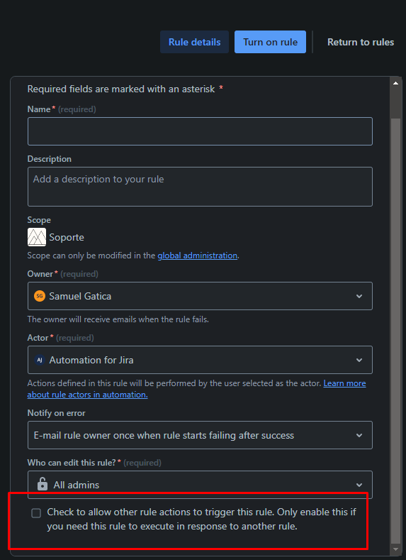

Hi @Steve Holland
Make sure the ckeck box "Check to allow other rule actions to trigger this rule. Only enable this if you need this rule to execute in response to another rule." is enabled for Automation #1
This way Automation #2 will trigger Automation #1
Best regards

That was it..So simple! appreciate it @Samuel Gatica _ServiceRocket_ !
