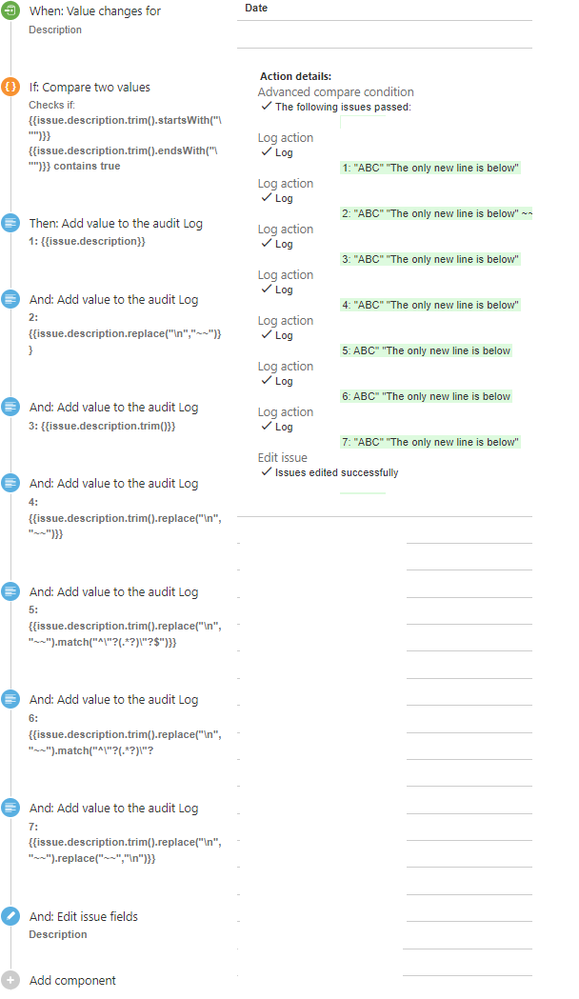

I've attached some troubleshooting I did (Note that audit log 6 is your full solution but is cut-off in the view) which I hope enables smarter minds then mine to solve this for me. The first screenshot is when the test description has no internal new lines, and the second screenshot is when there are internal new lines.

I am confused by what you are posting: what is shown for log entry 6 (i.e., what I suggested) works as you asked to remove the outer quotation marks.  And I just tested and it does remove embedded newlines as well.
And...if you use the expression I suggested, there should be no need for the conditions so that will simplify the logic to one step: edit issue on the description field.  For testing you can write to the log, but that will not show the newlines.
Please post the text you are attempting to parse as that may reveal what is happening.  And perhaps use the code formatting to ensure it reflects what you are using.
UPDATE: My testing showed that my expression does have a problem if there was a final quotation mark and the original text did not have embedded newline characters.
One more question: how are you importing the data?  When I just tried an import of a CSV file which contained quotation marks around a description with embedded newlines, the newlines were all removed completely, leaving no characters in their places.

Just want to confirm that you saw the two screenshots? The first screenshot shows that it works correctly when there are no internal new line the description, the second shows that #5 and #6 fail when there are internal new line.
The input description used can be seen best in #2 where I have replaced the new line with "~~". I think trying to write it in this comment will just get confusing when I attempt to describe the invisible new line at the end.

I did see the screen shots, and wondered if that was a long rule with an if/else condition or was multiple rule executions.  It appears to be different rule executions...with different Description values.
I also tested your #5 version, which essentially just drops the final replacement of ~~ back to newlines, and that worked for me.
When I create a sample file using Excel, using Alt-Enter to add the blank lines, and save to CSV, the CSV does contain the newlines.  After import, all newlines are removed: leading, trailing, and embedded.  The only way I was able to test was to edit the Description field.  This is why I asked how your import was performed.
At this point I have two possible hypotheses:
  • The rule is "glitched" as a result of too many edit / publish cycles, as this can sometimes break rules.  Two ways to check that are:
    • Disable your rule, wait a minute, re-enable, and retest it.  If that does not work...
    • Disable your rule, and re-create it with the simplest case possible: trigger on Description change and write #6 version to the log.  If that does not work...
  • Perhaps your Description field contains other characters we are not seeing

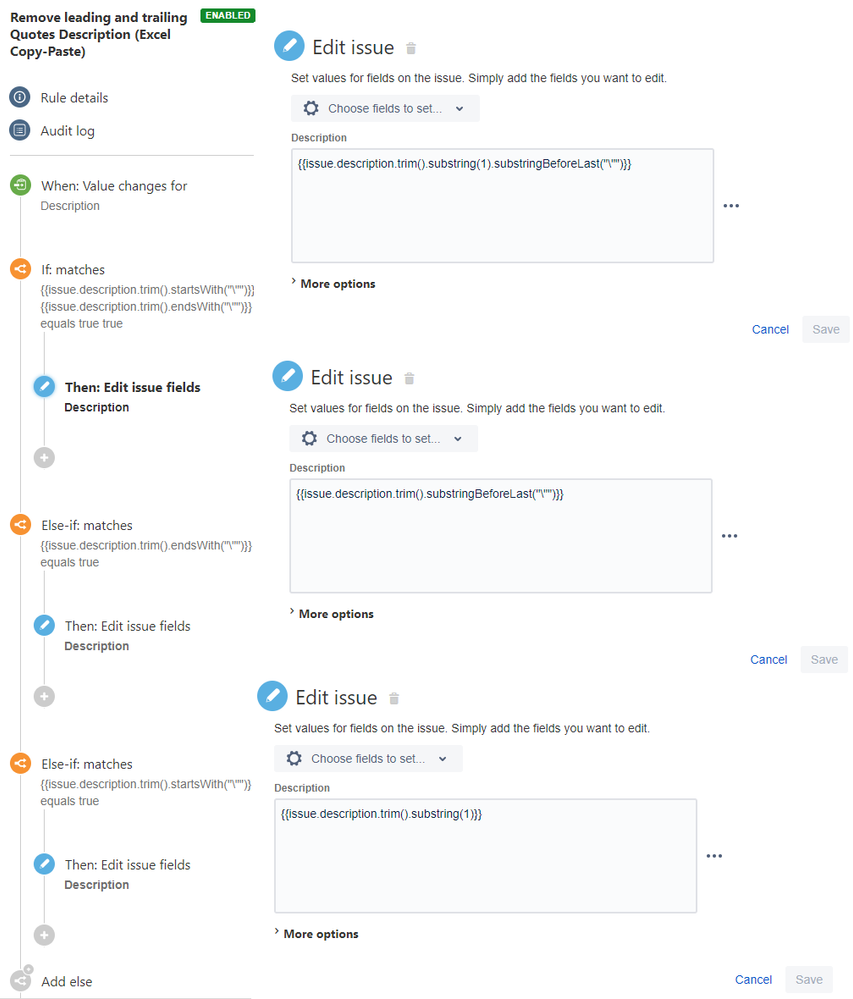

Hi Bill, I put this down to the match function not working on multiple lines. Instead I am now using the below workaround. I only want to edit the description once as doing it multiple times was self-triggering the automation to run again(is there a way to stop this?).
