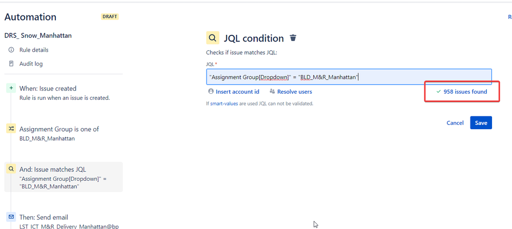

I have created an Automation trigger to send mail action for all the new issues types created based on the Custom field value condition. but apparently it does not work most of the time.

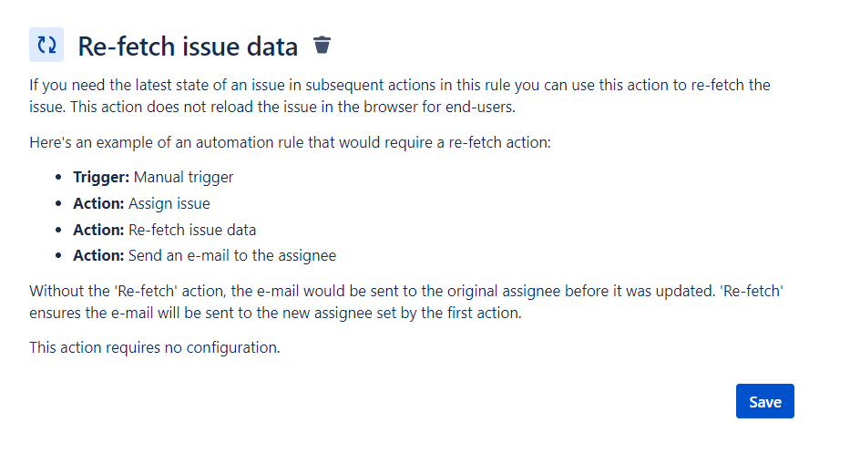

Since you are checking for Issue Create Trigger Event
The Best Practice would be to add the Re-fetch Issue Data Action before checking any condition
Let me know if it works
Thanks

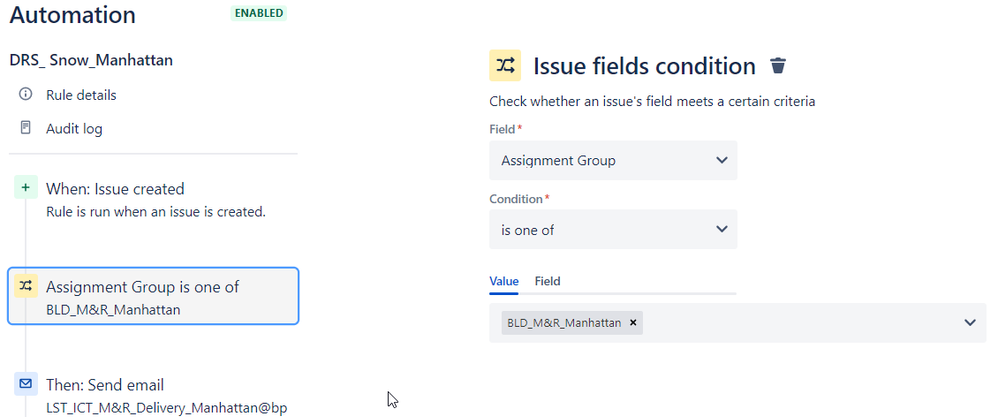

Your question's screenshot and Reply screenshot are not corresponding to the same rule.
Did you change the rule?
madhu.tejas
February 15, 2022
Yes i tried to change the rule again after (as seen original screenshot)- removed Refetch option.
trying different ways to make it work

Just an FYI...
I also recommend adding the Re-fetch Action after the Issue Created trigger when such symptoms occur...and I would not characterize it as a "best practice".  It is a work-around for a defect in the automation engine and/or REST API, whereby the event is firing before the event has completed processing.  Hopefully this will be fixed one day and this extra action will not be needed.

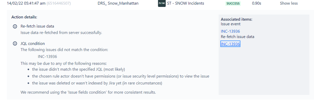

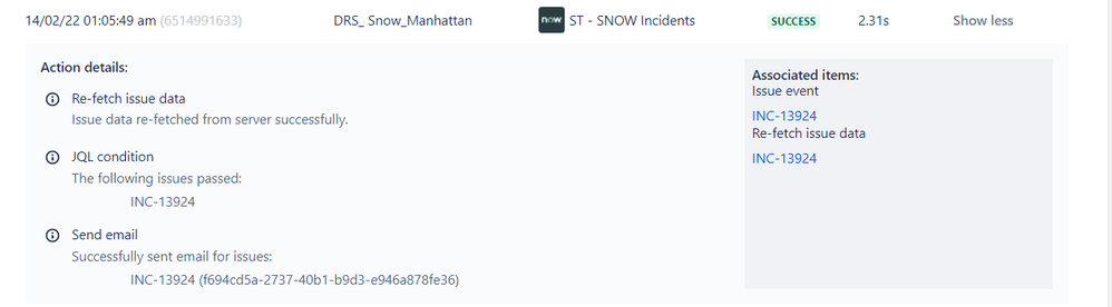

Hi, Yes but the audit log doesnot give teh right recommendation. I have tried all
Adding the screenshot when it worked and when it doesn't
- When Email was sent successfully
- Same condition when it was not sent successfully
. Nothing changed in between.
