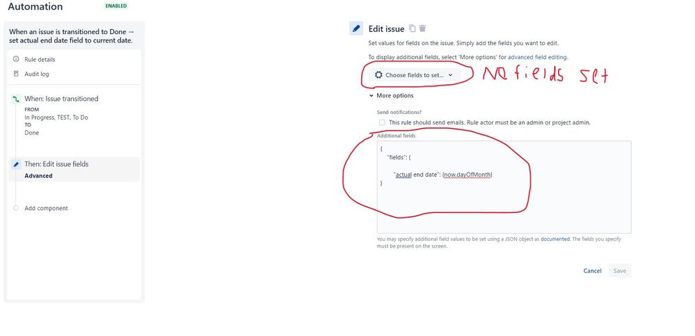

Here is my JQL, that didn't work:
"fields": {
"actual end date": {now.dayOfMonth}
Audit log regarding the automation that was tried to implement:
"Action details:
Edit issue
Error while parsing additional fields. Not valid JSON."

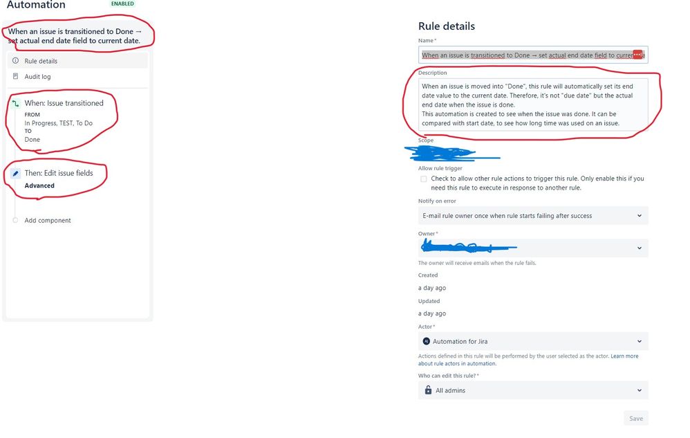

Screenshots of 'Custion field "actual end date"' automation:

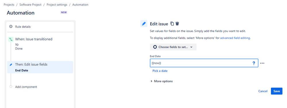

Hi @Fuji
Why don't you do the following?
Make sure to choose the "Actual End Date" on the field and type {{now}} on its value.

Thats really wierd. Yesterday when I made the custom field "actual end date", it was not shown in the "Choose field to set..." drop-down menu. Maybe it took time to update? I don't know.
But thanks anyway, I think it will work, or else I will write again. :)
Alex Koxaras -Relational-
May 4, 2023
@Fuji it doesn't take time to update. It instantly available. But if you created the field on another tab and you had the automation open, then this field will not appear in the dropdown. You would have to refresh your screen in order for the field to appear.
Let me know if you managed it!
Fuji
May 8, 2023
It worked. Thank you very much Alex :)
