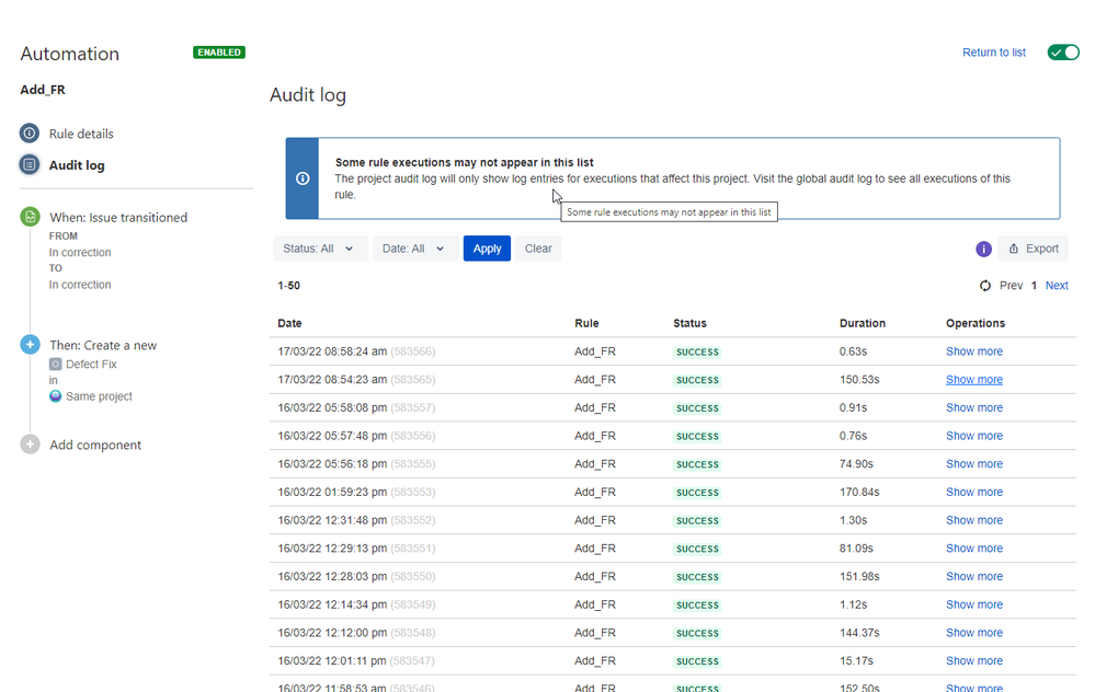

Hello experts,
I am facing a performance issue when executing automation rule.
"The call to the Jira server did not complete within the timeout period. We are unsure of the result of this operation."
The execution is very long = 150s at the first execution and following execution takink only 0.7s.
I don't understand why it is taking so long and how to fix it.

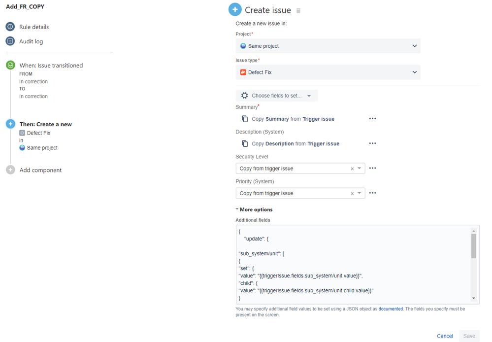

On  Defect Report issue we need to create immediately a Defect Fix using Automation rule.
This is taking more than 60s on first execution and following execution take 2s.
This morning i worked on this problem and after making some incremental tests i noticed that the root cause is related to some cascading fields that are present on the Defect Fix creation screen.
After removing these field from the screen the execution time is acceptable (less than 5s).
These cascading fields contain hundreds of options.
I don't know why this is taking too long to load on first execution ? Atlassian Developers should know.
Now that we have probably identified the root cause, do you have any workaround
except removing these cascading fields from creation screen ?

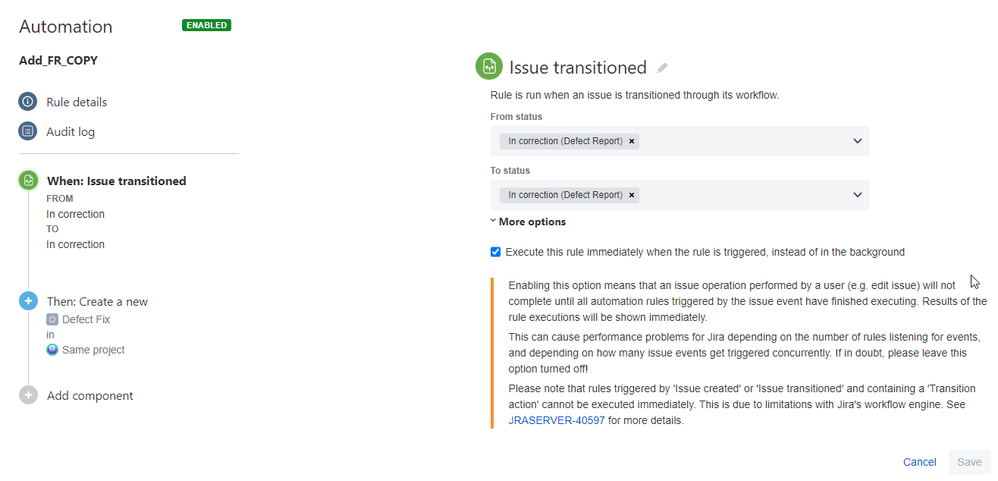

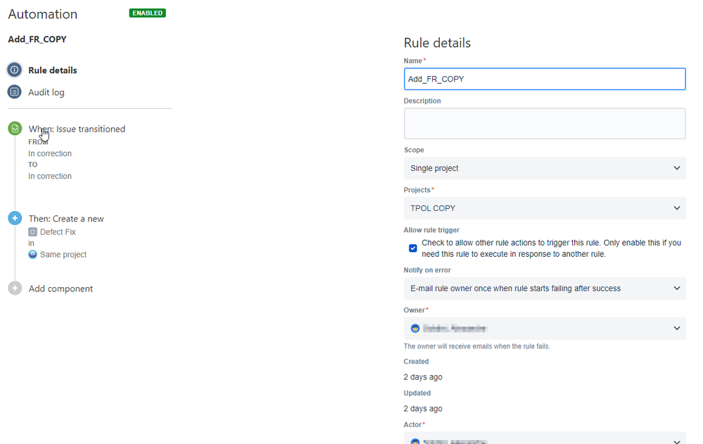

Could you share a screenshot of the configuration of your trigger?
Rachid El Mansouri
April 21, 2022
Hello @Mykenna Cepek
Please find attached the configuration of the trigger
Mykenna Cepek
April 21, 2022
Have you tried disabling the "Trigger > More options > Execute this rule immediately..." setting? It's pretty clear about performance impact.
Rachid El Mansouri
April 21, 2022
@Mykenna Cepek Yes we have tried disabling with no more success.

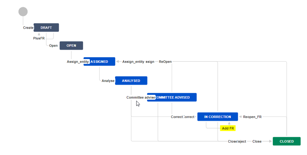

Why does your trigger use the same value for "From status" and "To status". That doesn't make sense to me.
Also, can you share a screenshot of the workflow being used by the project you are using for your testing?
Rachid El Mansouri
April 21, 2022
Rachid El Mansouri
April 21, 2022
We want to fire the trigger "Add FR" on the status "in correction".
Do you have another suggestion on how to do this ?

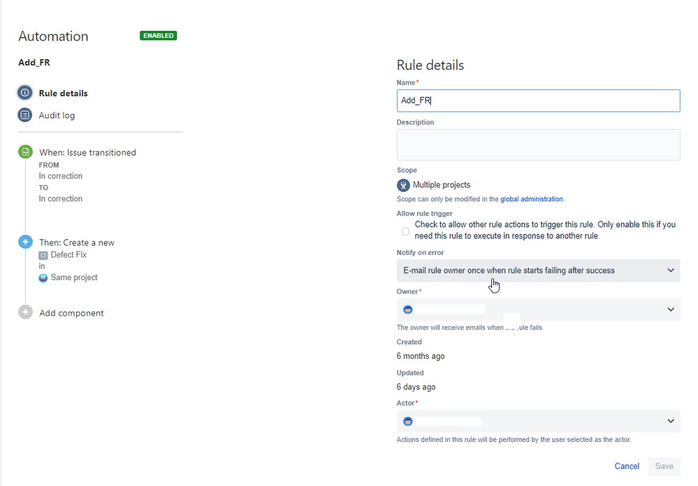

1. You are running this as a global rule - this means that any issues being transitioned will be evaluated again the rule. This could be a performance issue if you have lots of projects with lots of issues using these transition states. Advise: Try using a project rule, i e limited to one project, and see if this improves performance
2. Your trigger is transition from In Correction to In Correction - by definition transition should be between different states. I was expecting transition from two separate states, e g New to In Correction. Advise: review to ensure that you are using the correct states, and that these states are not use in other more frequently invoked work-flows
3. Review if you have other project automations or background jobs cannibalising your processing capacity. Project automation is AFAIK executed in a single thread with low(est) priority
Good luck!
//Jimmy

Usually when a rule has long execution time you end up with it being throttled. This is visible in the project automation audit log. Look for the yellow throttled status and check the entry. It will include the message "This rule execution exceeded allowed service limits for Automation for Jira. View performance insights."
If you select the link for Performance Insights it will show stats of the executed rules, including long avg duration. This could be helpful to understand if you have many rules with long avg duration that potentially is hogging all your resources.
Here is a link to the official documentation on how to optimise rule performance: Link to official documentation. Maybe there are some nuggets there that can lead you further.
If these capacity issues prevails, the next step would be to troubleshoot the server itself and tune it. Luckily, Atlassian has your back here with a really good guide: Link to official documentation.
Good Luck!
//Jimmy
Rachid El Mansouri
March 30, 2022
Hi @Jimmy Petersson
Thanks for your reply.
Actually, in the audit log the rule status is success and no error message is logged.
