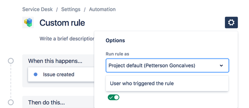

1 - Check if the user that triggered the rule is, in fact, the customer of the issue. More specifically, check if the automation is not configured to be triggered as a different user:

Edit: and the automation rule is set to run as the person who triggered it, not the project default
