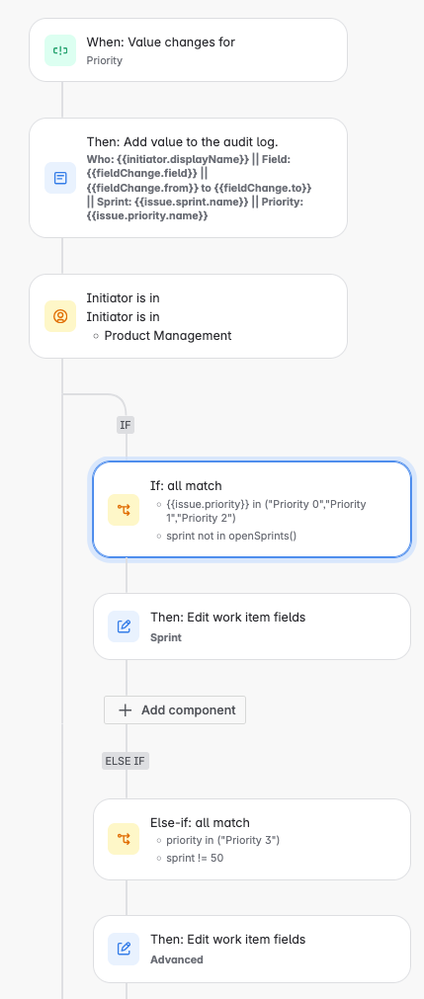

I have an automation wherein if the Priority changes, I want it to update the sprint.
If its in one of p0/1/2, it should go in the active sprint, p3, in a later sprint, and p4 in yet a different sprint.
I want to check to make sure the sprint I'm trying to change it to isn't already set.
In order to do this, I'm using the IF/ELSE branch, and using the "all of these conditions met"
However, I can't wrap my brain around the difference between smart value and JQL

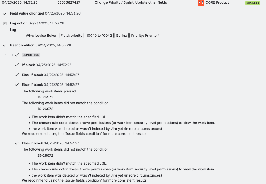

In my workflow below, the ifElse w/ Prioirty 3 will not punch if the priority field is updated to P3. In my audit log, I'm getting:
The following work items did not match the condition:
  • The work item didn't match the specified JQL.
  • The chosen rule actor doesn't have permissions (or work item security level permissions) to view the work item.
  • the work item was deleted or wasn't indexed by Jira yet (in rare circumstances)
We recommend using the 'Issue fields condition' for more consistent results.
 It has the proper permissions, so it must be that I entered in the JQL wrong. So.. am I supposed to use smart values (like I attempted in the FIRST IF block?

For your first JQL condition on priority, you use the smart value for priority on the left side of the expression, which will likely fail trying to compare a number to a field (which JQL cannot do).  Please try using just the field name:
priority IN ( "Priority 0", "Priority 1", "Priority 2" )
The rule already has the issue in scope, and so it is only checking that specific issue with the JQL.

As in, if the issue was in priority 3 and NOT in the sprint (so, the condiitons are met) it's "succeeding" with no change made with the error I listed, rather than performing the "then" step I provide.

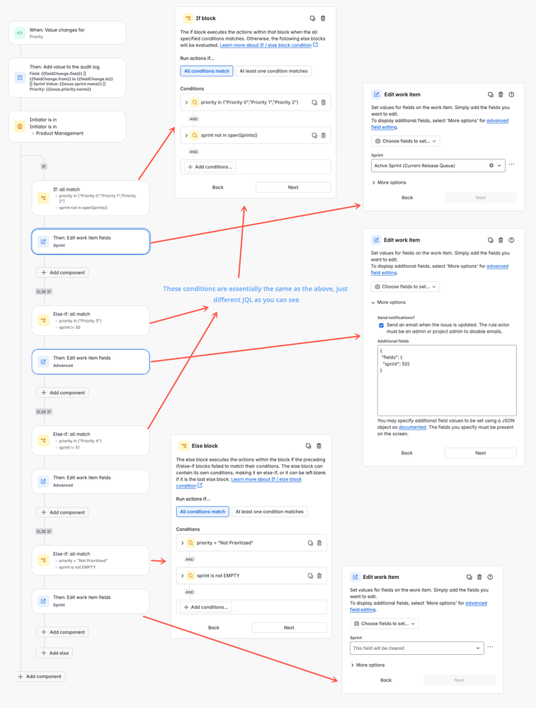

Would you please post an image of your current, complete rule in a single image (for continuity) and another of the audit log details showing the rule execution (with all the areas at the right side expanded)?  Those may help to explain what you are observing.

Yes, attached! It's quite long, sorry!
Long and short, the goal is this:
1. If the priority changed, make sure it's in the appropriate sprint.
  • Priority 0 / 1 / 2 map to Active Sprint
  • Priority 3 maps to a next sprint, with the value of 50
  • Priority 4 maps to a next sprint, with the value of 51
  • "Not Prioritized" priority should have the sprint emptied, if it isn't already empty.
2. If sprint is already appropriate, don't change it.
In the example, you can see I have a log action set up. It's reporting that I did the action, and I am in the group Product Management. Additionally, I am an admin on Jira and on the project, so I should have sufficient permissiosn.
The field updated was priority. It went to Priority 4. The sprint was blank. That means it should have hit the second else-if block. You can see that it passed one, but then I get the error that it didn't match the condition. No change was made to the ticket. Screenshot 2025-04-24 at 1.45.26 PM.pngScreenshot 2025-04-24 at 1.35.00 PM.png

Let's try a simple change first:
Anywhere you are testing for the sprint not equaling something, consider if it could also be empty.  And so for the first condition with JQL, that should be
sprint NOT IN openSprints() OR sprint IS EMPTY
Please consider your other conditions to decide if that clause applies when comparing sprint not equal to 50 (or 51).
I recommend pausing to create a logic-table to identify the test cases (for sprint, priority, and permissions) to ensure you test all possible cases.
Finally, at the very top of the rule, do you want an additional condition to check if a work item is not completed?  That will prevent any accidental assignments to sprint if someone mistakenly changes a completed work item.
