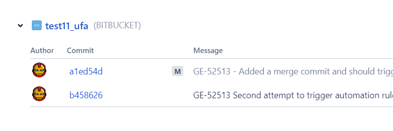

I am setting up some automation rules to capture {{commit.hash}} for every commit created using the 'When Commit Created' trigger.  The rules does get triggered when I make a commit to my dev branch (b458626). After merging to the 'main' branch, this merge commit does NOT trigger the rule (a1ed54d). Is the rule making a distinction between a commit and a merge commit?

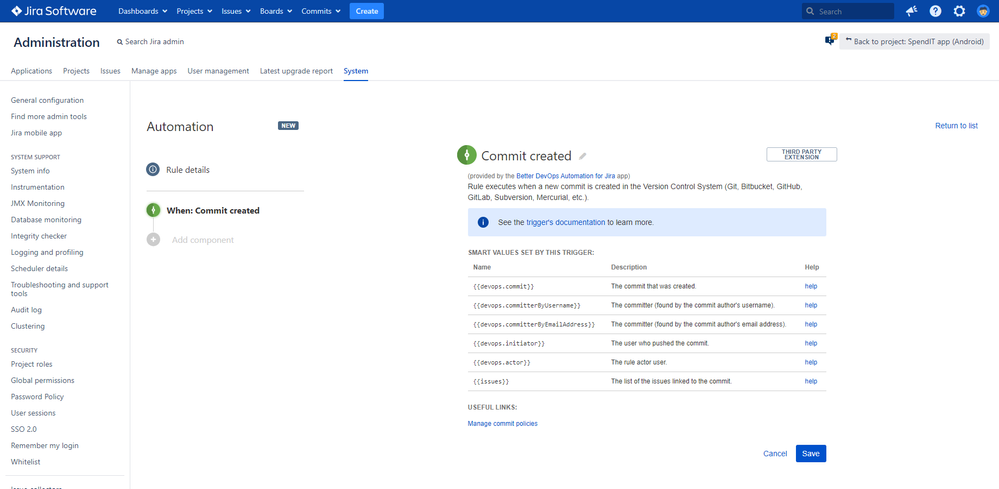

Funnily, we develop the DevOps Automation app for self-hosted Jira, and our Commit Created trigger works as you wrote: we provide a {{devops.commit.isMerge}} smart value which you can use to filter merge commits:
You confirmed that it is an intuitive design. :-)
