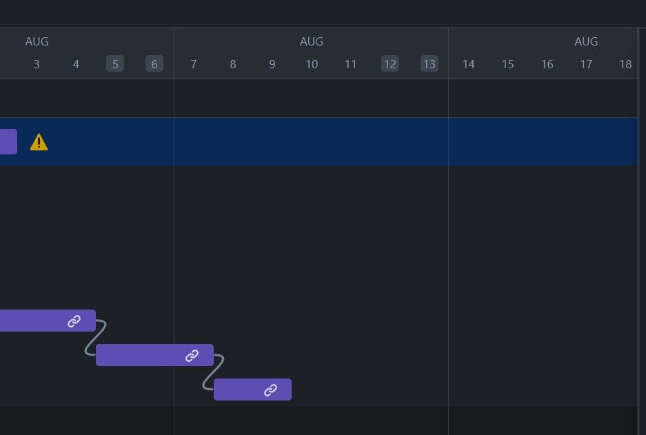

TomT
June 30, 2023

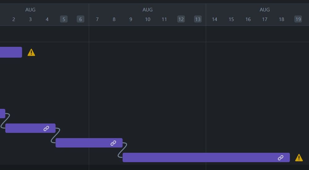

I made the date in the automation to move the start to august 18 and started with the timeline below.
Then I moved the second to last issues end date from august 7 to august 8.
After a second it changes to the screen below.

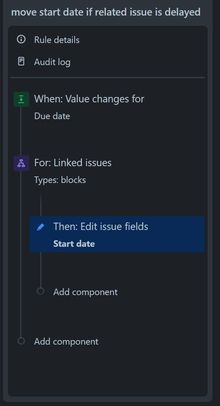

Marco Brundel
June 30, 2023
Hi @TomT ,
What have you set up behind the Start Date field? Did you use a smart-value there to copy Due date?
Regards, Marco
TomT
June 30, 2023
Just to test I currently have a fixed date there.
I would want to place a smart value there meaning, the difference in days to the other issues end date has moved, is added to the start date.
But if I run this now for some reason my end date moves....
Like # people like this

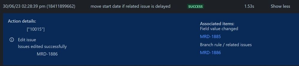

TomT
June 30, 2023
Audit log is below. No it the result is not as expected.
The end date moves instead of the start date.

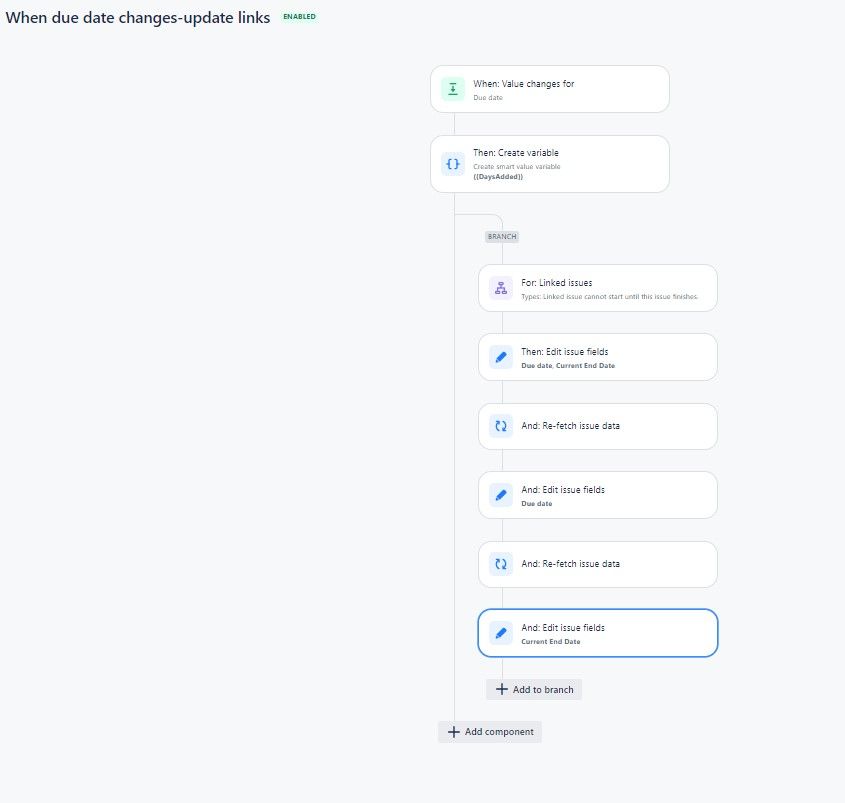

Patrick FG
January 16, 2024
hi @Ste Wright ,
Here is my screen shot that I made out from your instructions. We are on the cloud service.
Like Çağrı Akman likes this
Ste Wright
January 17, 2024
Hi @Patrick FG
Does the rule error? Is there anything in the audit log in terms of details?
It's difficult to know what might be inaccurate without seeing more specifics within each step.
Ste

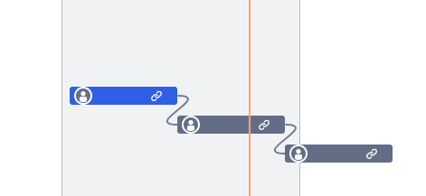

Ahmad Khamash
July 25, 2024
Hi Ste Wright
Thank you for the solution provided,
I have been trying the same thing worked for me, yet it does not work on cascading issues ( multiple blocked issues, )
reference below :
On changing issue #1 rules works perfect on Issue #2, Yet does not follow to Issue #3
Did you face this issue,
Note: I'm on cloud.
