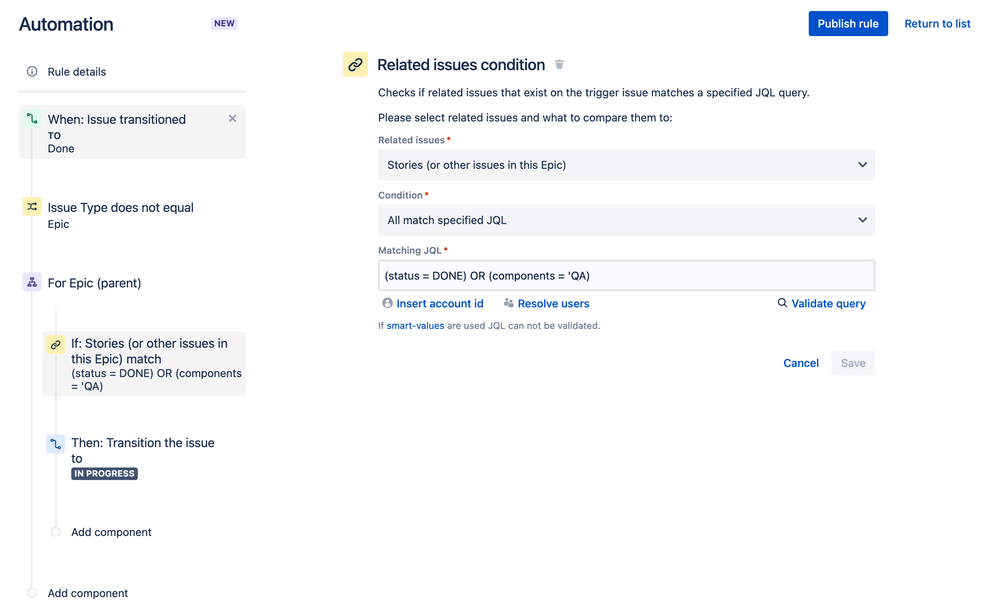

You should be able to do this with some branching and the related issues condition:
Screen Shot 2022-10-07 at 9.41.11 am.pngThis example needs some extra checks that @Trudy P Claspill did with checking the components and not sub task, etc but this should show you how to do it.
We branch onto the epic and then use the related issues condition to check all the issues in the epic match some JQL. This is the tricky bit. The JQL then checks that the issues are all in Done (change this to your final state) OR that they are QA tasks. I can't get it to check that there is exactly one QA task.
I think this should get you to where you want to be.

Ah, that's how to go back down to the children of the Epic after having branched up to the Epic from a child! Thanks for showing that @Simmo

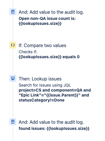

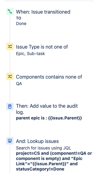

I managed to create a rule that gets most of the way there. The last thing to add is something to loop through the final set of Looked Up Issues (the found QA issues) to add comments to them. I'm sure it could use some refinement.

The first three components are ensuring that it is a transition to Done (you would need to add Cancelled) on a non-Epic, non-Sub-task issue that also does not have QA as a component.
The next step is to look for any issues under the same parent Epic that do not have QA as a component.
Before that Component it would be good to add a condition that confirms the triggering issue actually has a parent Epic.
After doing the lookup I use a Log Action to see how many issues were found, then a Condition to proceed only if the count found is 0 (no non-QA issues remain incomplete).
Then I do another lookup to find all the QA issues that are incomplete, under the same parent as the triggering issue.
The last thing I do is use a Log Action to print out the count of QA issues found.
It is at this point you would need to add components to add a Comment to each issue returned in the last Lookup Issue action.
