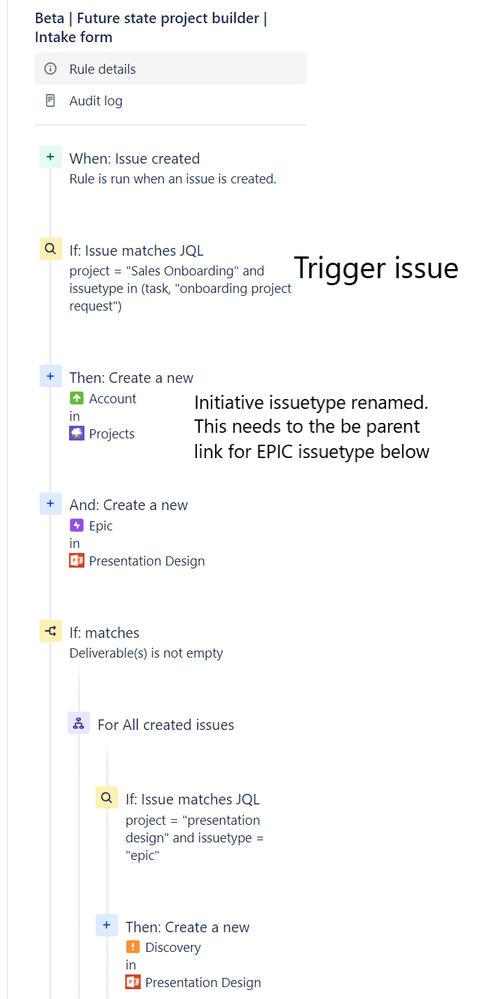

Hi @Ethan V. , @Jan Stähle @frother
How would i set the parent link with the attached automation for the EPIC. The trigger issue is service desk issue type, which then creates our ACCOUNT issue type (we renamed the initiative issuetype) and make the ACCOUNT the parent link for the epic. I cant seem to get the above to work and its vital that this automation creates the account as the parent link for the epic
