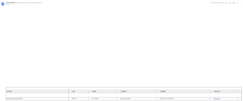

Okay, understood. As an alternative, I am displaying issues in the form of a table in the email and it is displaying as per requirement but the gap above the email is too big and I am not able to reduce it. How can I reduce the space?Screenshot 2025-02-17 143339.png
This is what I have written in the email action -
{{#lookupIssues.size}}
<table border="1" cellpadding="5" cellspacing="0" style="border-collapse: collapse; width: 100%; text-align: left;">
<tr style="background-color: #f2f2f2;">
<th><strong>Summary</strong></th>
<th><strong>Key</strong></th>
<th><strong>Status</strong></th>
<th><strong>Assignee</strong></th>
<th><strong>Updated</strong></th>
<th><strong>Issue Link</strong></th>
</tr>
{{#lookupIssues}}
<tr>
<td>{{summary}}</td>
<td>{{key}}</td>
<td>{{status.name}}</td>
<td>{{assignee.displayName|default("Unassigned")}}</td>
<td>{{updated.convertToTimeZone("Asia/Kolkata").format("yyyy-MM-dd HH:mm:ss")}} IST</td>
<td><a href="https://yourcompany.atlassian.net/browse/{{key}}">View Issue</a></td>
</tr>
{{/lookupIssues}}
</table>
{{/lookupIssues.size}}
{{^lookupIssues.size}}
<p style="margin-top: 5px;">No issues were updated in the past week.</p>

Vishal Biyani
February 17, 2025
@Mohit Edupuganti
Can you share the code of how you are formatting the table? then only people can help you solve the issue
Mohit Edupuganti
February 17, 2025
sure. Below is what I have written in the email action -
</tr>
{{#lookupIssues}}
<tr>
<td>{{key}}</td>
</tr>
{{/lookupIssues}}
</table>
