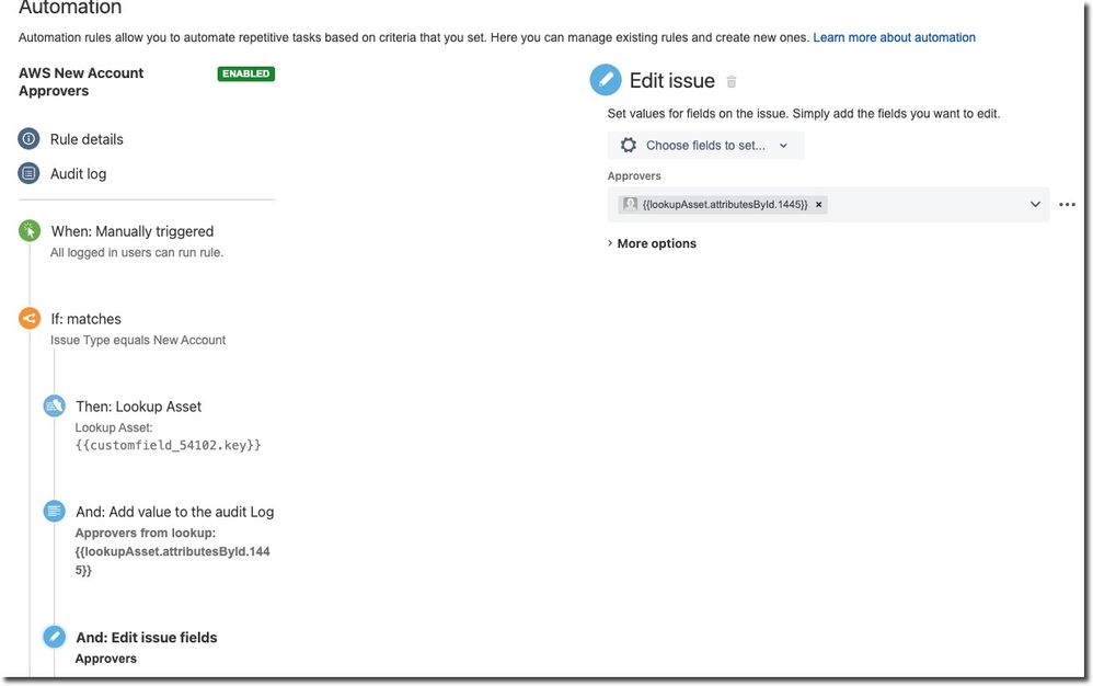

We have an assets object type with an attribute (id:1445) Approvers which is of type users and can hold up to 2 names.assets.jpg
We built an automation rule to fetch these names and insert them into the issue Approvers field, taking the object value from the issue {{customfield_54102.key}}.
The component Edit issue fields works fine with the smart value as long as the Assets object contains 1 name, and then, the Approvers field in the issue is properly populated with the name.

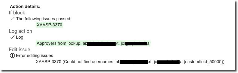

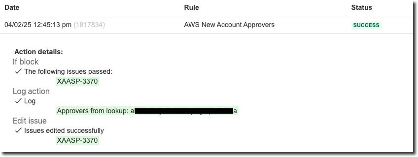

However, if the Assets object contains 2 names this approach does not work. The names are retrieved from Assets and logged properly, but the automation fail.

According to the documentation we tried Advanced Editing in may ways like:
{ "fields": { "Approvers": {{lookupAsset.attributeById.1445}} } }
or
{ "fields": { "Approvers": [ {{#lookupAsset.attributeById.1445}} { "accountId": "{{accountId}}" }{{^last}},{{/last}} {{/lookupAsset.attributeById.1445}} ] } }
Generally, these approaches provide a success in the automation, but the field in the issue still reamins empty.
I'm not able to understand the format comming from Assets. Is it a list of strings? a string representation of a list? How can I parse it to properly fill the Approvers field? Am I missing something else?

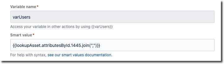

The solution for this is to force the asset data to be fully resolved before used in the dynamic JSON, by first storing it in a variable:
  • action: create variable
    • name: varUsers
    • value:
{{lookupAsset.attributeById.1445.join(",")}}

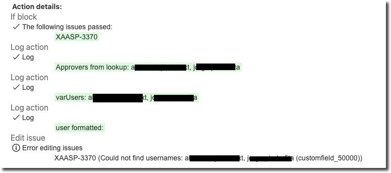

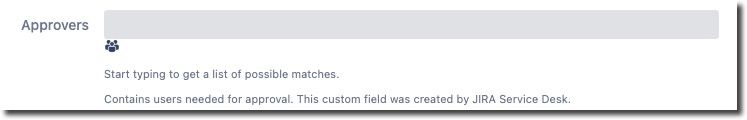

Thanks for the answer. Holding the value in a variable is a nice idea. After implementing your proposal I started getting the following error:
XAASP-3370 (Could not find usernames: a***k.j***t (customfield_50000))
After a search, I found this KB. The customfield_50000 (Approvers) is a user picker field. I tried to display the name in another variable with the format described in the KB note (just for log, not updating the field):
{{#lookupAsset.attributeById.1445}}[~{{name}}]{{^last}},{{/}}{{/}}
or
[~{{lookupAsset.attributeById.1445.name}}]
I did this with 1 or 2 names coming from Assets. The first variable varUsers displays the content but it is not recognized by the content picker.

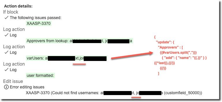

"update": {
"Approvers" : [
{{#varUsers.split(",")}}
{ "add": { "name": "{{.}}" } } {{^last}},{{/}}
Could the simplified Edit Issue Fields component have an intermediate step under the hood to convert the user that I need to implement?

Hi @Jorge -- In the audit log you show, it appears there is a comma-followed-by-a-space delimiter between the names, and not a comma only.  That would then not work with the JSON expression I showed.
Please post an image of the action where you create the variable varUsers to help confirm that.  There may be extra spacing in the object attribute that needs to be removed with the trim() function.

We discovered the reason why this whole thing is not working... It is a silly Crowd problem as the account IDs we are getting from Assets differ from the account IDs in the ticket (for the same user). When I get more information I will paste the whole working solution.
