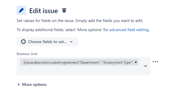

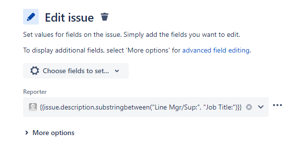

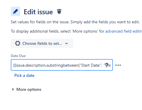

I have created an automation to populate the reporter field using the description field. We have a form that comes through as a request which has the reporter so Im using the {{issue.description.substringbetween("", "")}} smart value in an automation to pull this from the description but it doesnt do anything.

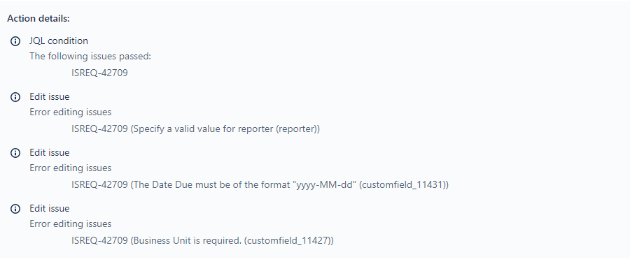

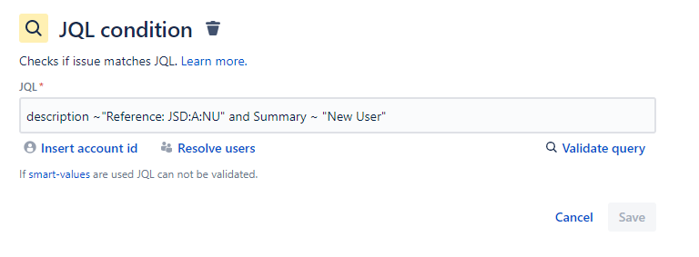

Here is my automation
Can you please let me know what I am doing wrong?

OK, so we have a Nintex form that the manager's fill to setup new users in the company. Once this is completed it is sent to Jira as an IS request so we can create the accounts. Currently, when this forms come through , Nintex is identified as the reporter in Jira. We want to change this.
So, the reporter field becomes Nintex  and the description gets populated with the contents of the form. We are happy with the description part but not the reporter.
At present we manually put in the reporter based on the contents in the description field but we would like to automate it.
I created an automation with smart values by looking at some examples provided by the Atlassian Documentation but it didnt work and gives the error that I have added in the original request.
