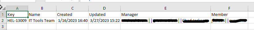

1: Eport from the IT Tools Team Object, Manager exports as First Name Last Name||   I was expecting an IDTeam Export.png

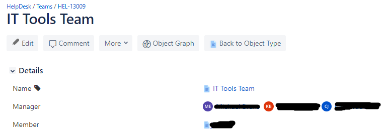

2: Showing the team with multiple users in each attribute

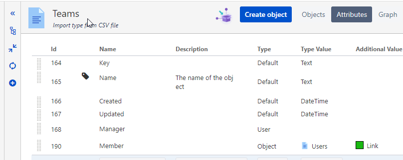

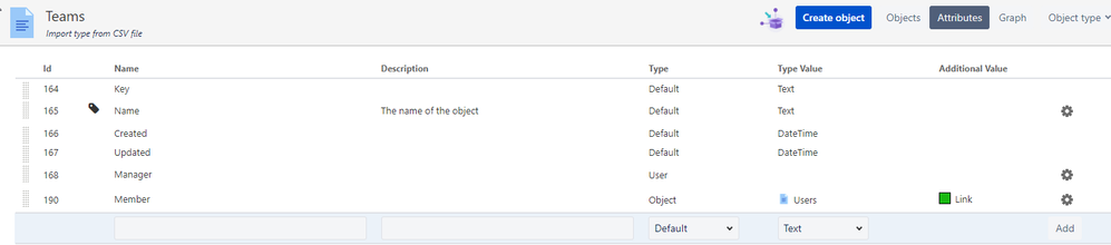

3: Showing the Team Attributes

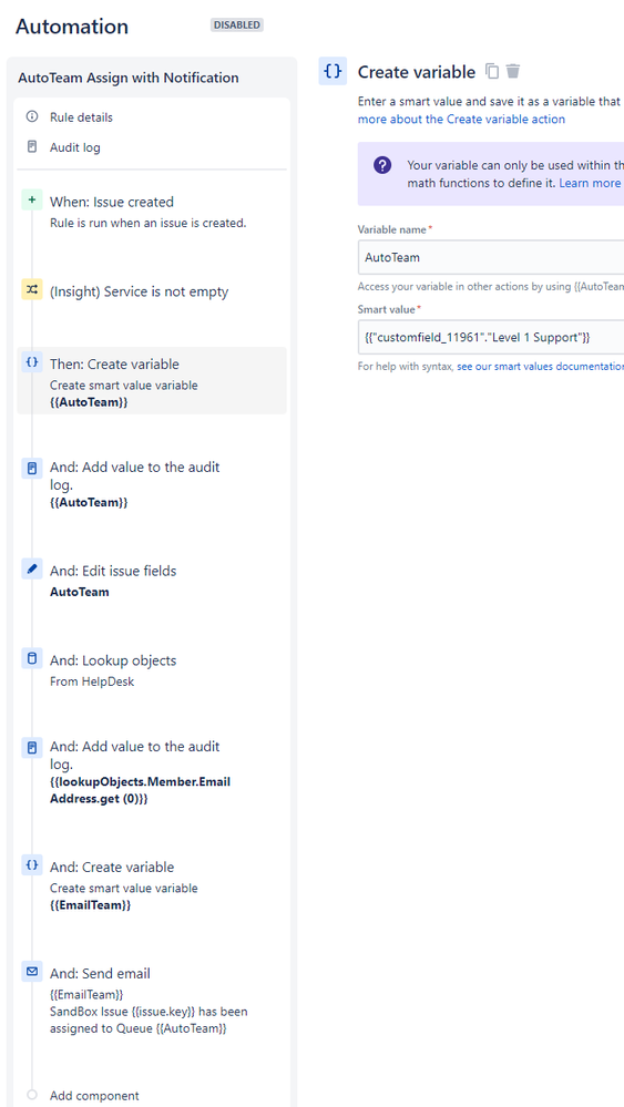

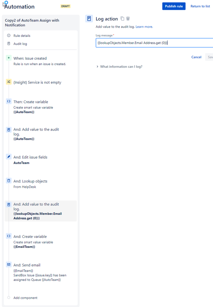

4: Automation being ran
  • on create trigger
  • Validate the Service field is not empty ... We are trying to auto assign based on a support team defined for each service
  • Create variable AutoTeam {{"customfield_11961"."Level 1 Support"}}
  • Edit issue field AutoTeam with variable output (IT Tools Team) in this case
  • LookupObjects to search the Team Object of AutoTeam objectTypeId = 29 AND Name = "{{AutoTeam}}"
  • Add Value to the audit log to validate who will be sent an e-mail
  • Create variable with that value (EmailTeam)
  • Send e-mail via that variable
