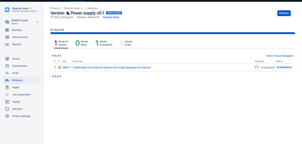

Also I might be reading into your example too much (Label name: Release 1.0) but have you thought about using versions and releases instead of labels for this kind of tracking?
If you go to the Releases page you can create a version (e.g. Release 1.0) and then link issues to that version using the fix version field. This allows you to track your progress towards a release. You can also add automations to trigger when you release a version (e.g. send release notes of all the issue completed in a version).

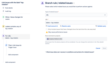

JD
January 7, 2021
Ok @Matthew Day , I'm not sure if I've got it 100% but here is a starting point.
This automation runs every time the labels field is updated. There is a condition to check that the label is log-rotation. If it passes the condition then it searches for all the other issues with the same label and links each of them to the issue that triggered the automation. Below are some more details on each component in rule and also some thoughts on making it more specific:
  • Use the field value changed trigger and monitor for labels to be changed
  • Using the issue field condition check if the label field contains the log-rotaion label. I've used contains any of as the operator because if you choose equals and there is more than one label assigned to the issue it won't pass the condition.
  • Using a branch rule / related issues look for other issues that already have the log-rotation label assigned to them. I used a JQL for the type of related issue and just put labels = log-rotation for the JQL search.
  • In the branch add the link issue action and choose relate to and trigger issue.
A word of caution with this: As you use the label log-rotation more and more it will increase the number of tickets that are linked to your issue. So at some point you might end up with more than 100 related issues. Is there any other criteria you can add to the JQL search in the branch component to make sure only relevant issues are linked? Maybe by creation date or status?
  • created >= -52w will only link tickets that were created in the past 52w
  • status in ("TO DO", "In Progress") will only link issues that are open
Let me know if that helps
- John
