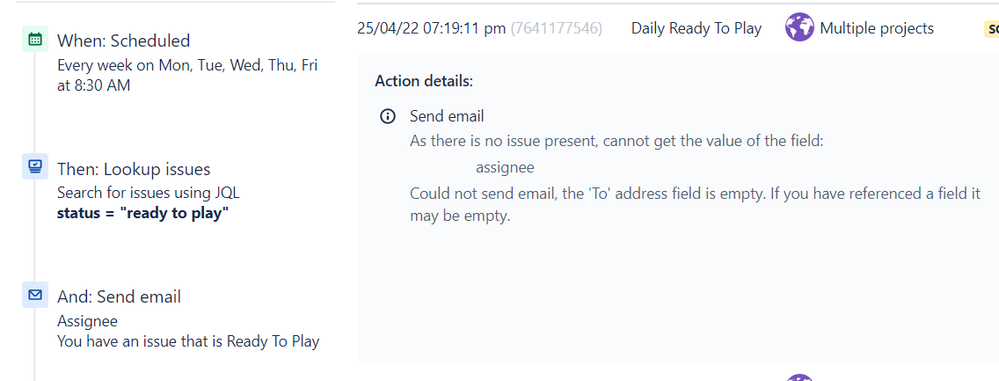

I set up an automation rule to email the assignee a list of their tickets that were in a particular status.  This worked fine until last Friday.  Now I get an error and the automation rule no longer works.  What am I doing wrong?  Each card does indeed have an assignee.  I verified each one myself.

I suspect the issue is in the email body and/or that the lookup issues action returned no results.
To fix the second problem, please add an advanced compare condition before you send the email
  • first value: {{lookupIssues.size|0}}
  • condition: greater than
  • second value: 0
If you want to email even when there are no issues, you may need to adjust your email body or instead use an if/else structure in your rule.

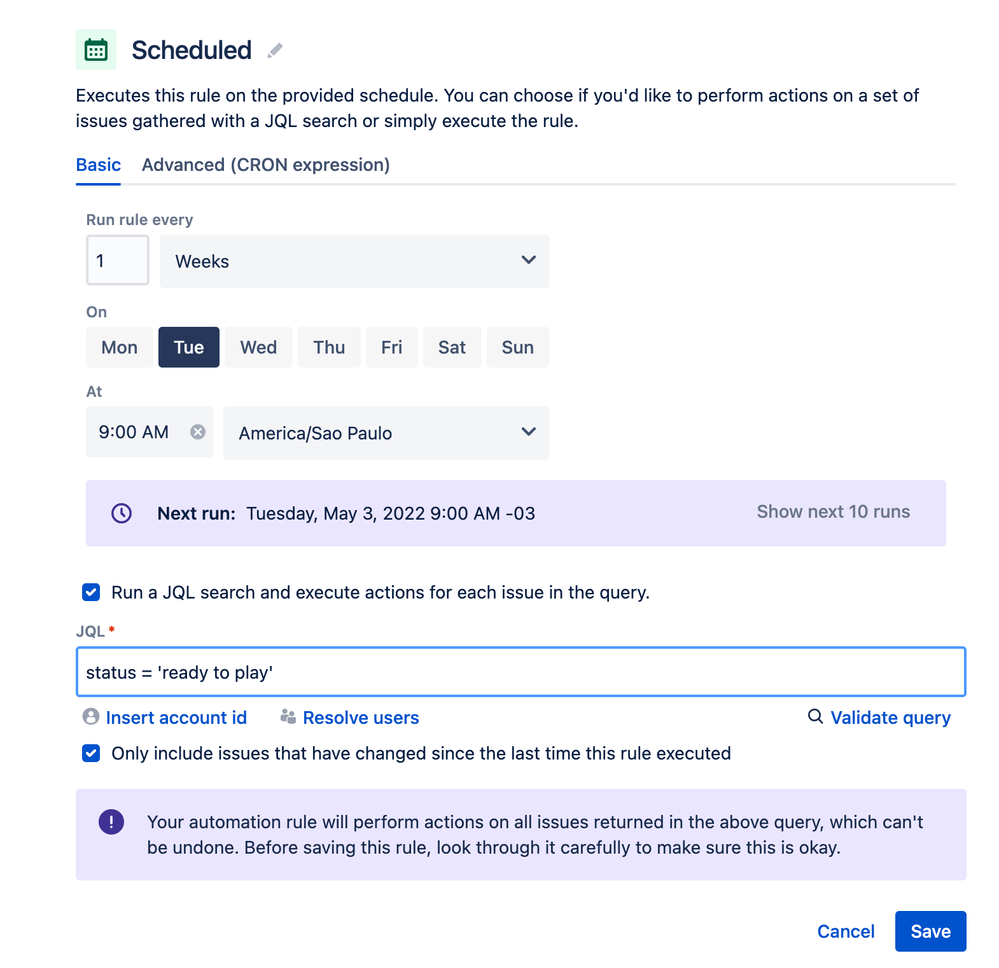

Could you clarify if you're running a JQL in the "When: Scheduled" component?
Since your lookup action is quite simple, I'd suggest adding that JQL on the first component.
If you still prefer to use the Lookup issues then you'll need to use the {{lookupissues}} smart value and iterate through it to send the e-mails.
